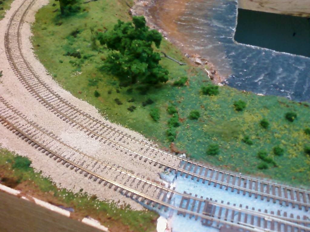

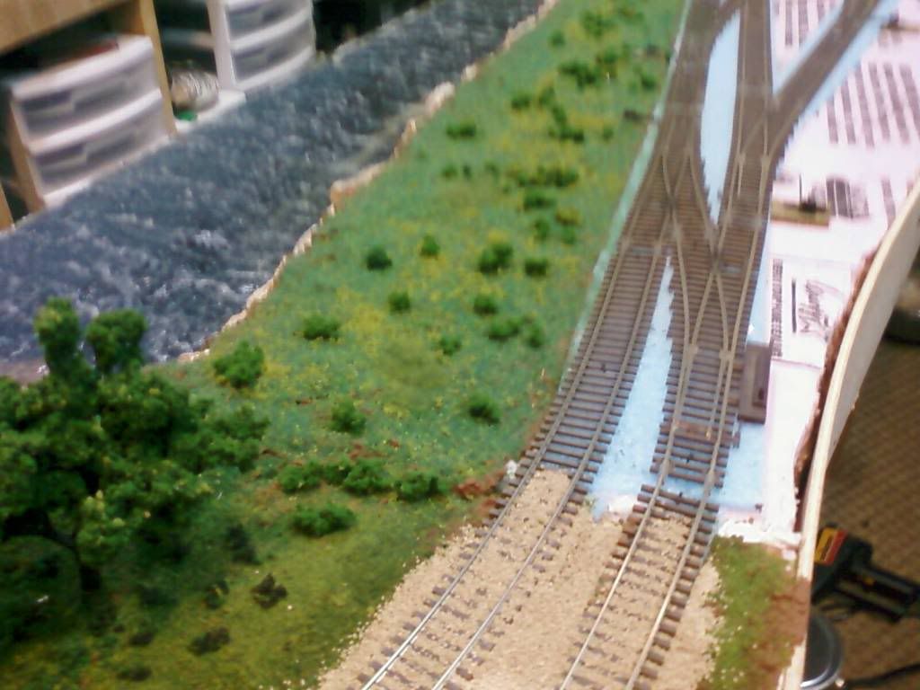

I used something similar, mine is blue. I had problems with track pins, but if I clue the track down, it seems to work fine. Here are a couple of picsFoam InsulationPics with foam insulation
That looks like the stuff, only different color. I am going to try it in the yard and see how it works. It has a kinda slippery surface but I am going to piant it with some type of plastice adhesave paint to help make everything else like the ballast adhere. I will let you know how it goes. Thanks for the info.
