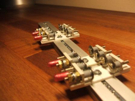

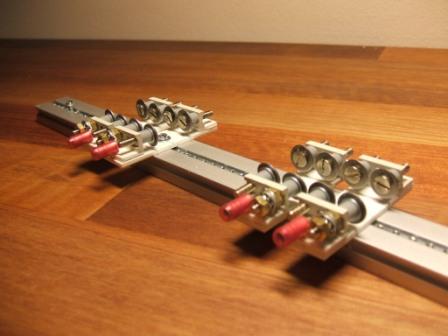

This is my testbed still under construction. The washers will be replaced by roller bearings once I find some suited for the project. Each set of rollers can be adjusted to fit various locomotives. The base is some alu-profile I just happend to have lying around. Middle rail power (for us Maerklin C-track users) is yet to be installed.

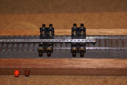

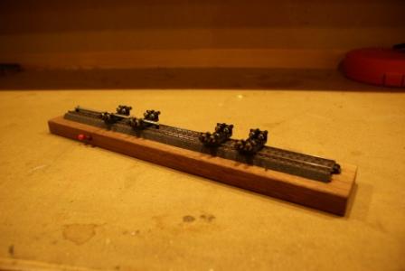

Well, this is what it finally ended up with:
Total cost is around 30 USD. A lot of money saved…
All materials is from the local DIY exept the rollerbearings which were bought in a RC-car shop at approx. 1 USD per piece.

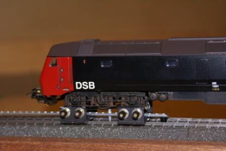

Even at higher speeds, the locomotive remains stady on the rollers.
wow this thing is nice
