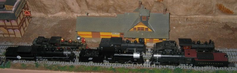

The “fleet”
Brass 2-6-0 (converted from a 2-6-2) with can motor and Lenz controller.
Roundhouse shay (constructed from a kit) with open frame motor and Lenz controller.
AHS (Rivirossi ?) 4-4-0 with tender drive can motor and Lenz controller.
(2) Proto 2000 0-6-0 with QSI sound.
Bachmann diesel (cheap - purchased with my Prodigy Advance DCC for debugging purposes)
Roundhouse 4-4-0 under review.

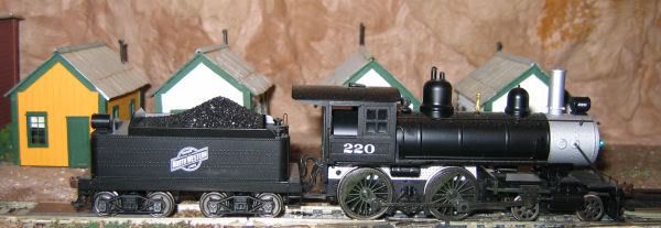

Regarding the engine being tail heavy, where would you estimate this engine, without the tender attached, would balance? On a model steam locomotive it is usually best if the balance point is close to midway between the first and last driving axles. This means it is probably a good thing for a 4-4-0 to be somewhat tail heavy. Lead and trailing trucks should stay on the track with their own weight or with the assistance of a light spring.
One minor point… You mention the locomotive having traction tires on the rear drivers. However, photos seem to indicate the traction tires are on the front drivers (i.e. the geared axle). Might this be an inconsistency that varies from one model to the next?

You are correct about the front dri
