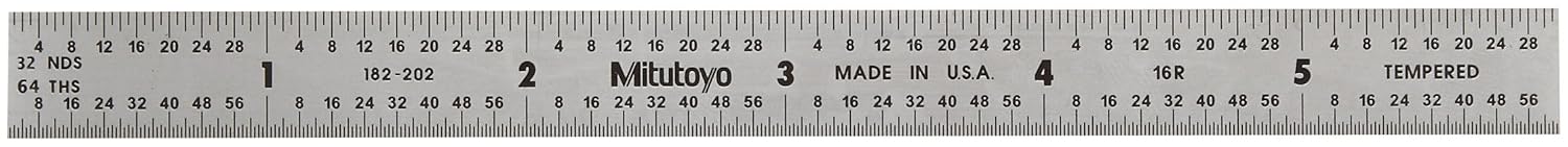

I like to use a scale marked in 1/50 inch, because I like working in decimal and the 1/100 inch markings are too difficult to read.
Thus I use Mitotoyo or Starrett scales. Those are not silver reflective, but a frosted grey color (with black markings). They are very easy to read.

Here’s the scale I use almost all the time:
They are showing the fractional side. The other side (the one I use) has 1/50" and 1/100". Note how easy it is to read the numbers: frosted grey with ENGRAVED numbers in black.
I also have the same version in a 12"–a bit less handy, but needed occasionally.
