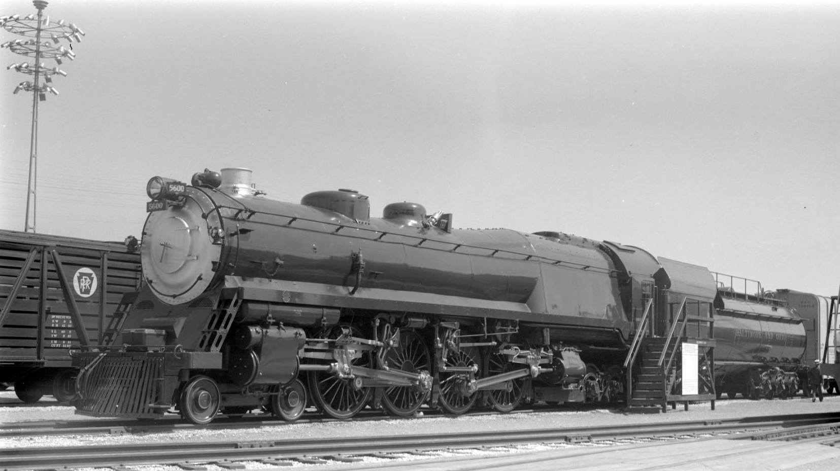

The Royal Scot, however, took a complete train representative of the train of that name. It appears that Otto Perry got a photo of 6100 in Denver CO, so the Royal Scot certainly got around.

Picture from Fair of the Iron Horse stereoscopic slide set.
For those that want to see the picture, go to the Denver Public Library site, and search OP-20568.
The locomotive looks very odd with a top mounted headlight and no smokebox access keys on the front.
