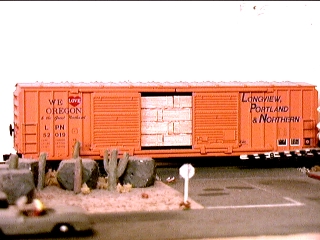

I have some cars that the loads make them over weight but I’ve never had any problems with them. The Chooch lumber loads I installed in double door boxcars are heavy and I have to add weight to the other side to keep the cars balanced. I only put them on one side so they can be seen when unloading at the lumber store. I keep the factory weight in the car because it helps keep the model rigid so it doesn’t sag.!http://www.trainweb.org/lonewolfsantafe/lp52019.jpg
