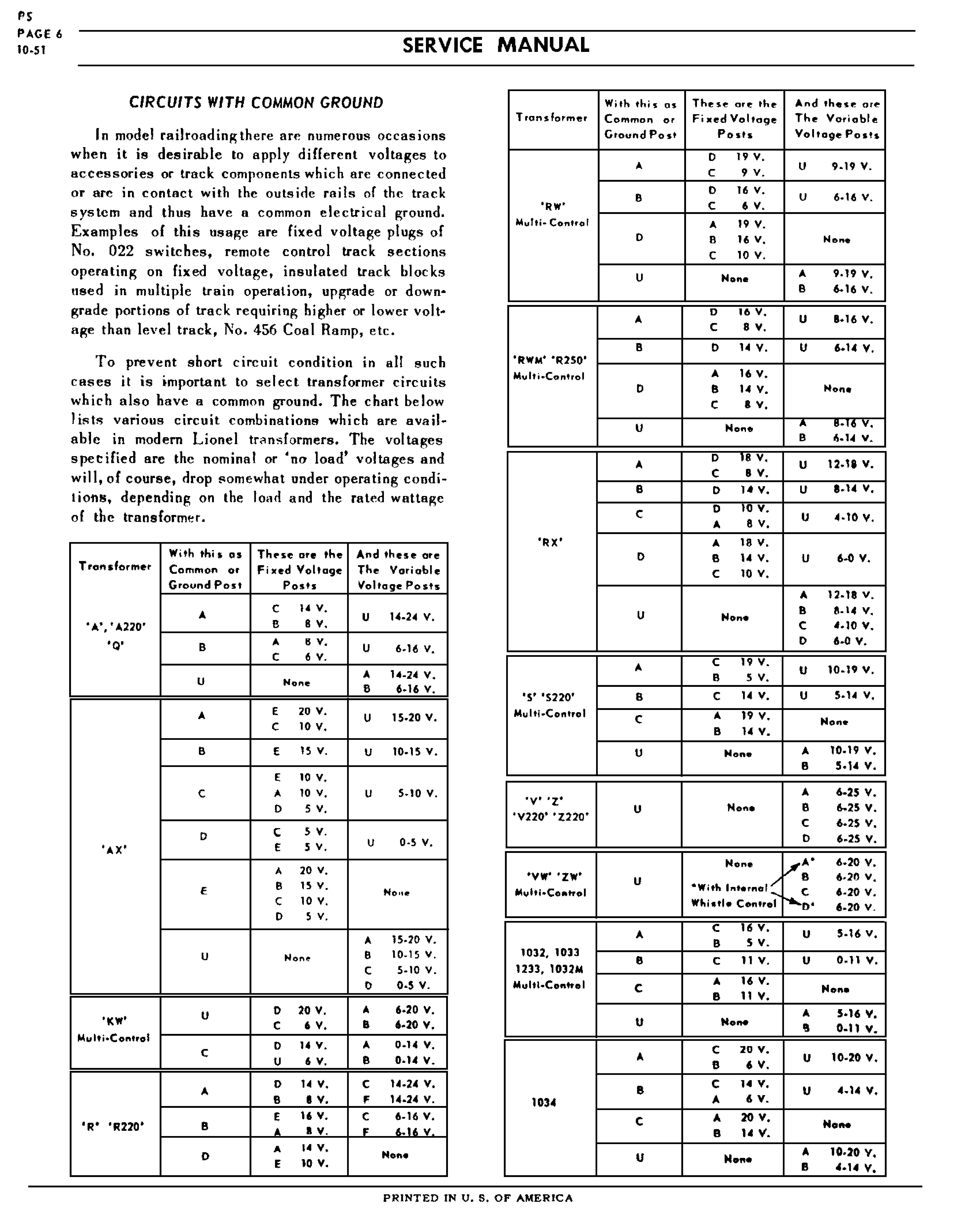

I went back to my Greenberg manual and found the table outlining the various circuits for all of the postwar transformers – both RW and 1033 are listed there. I was interested to see for the RW are rows showing posts A and B as common, but there is also a row also listing voltages when U is used as common. Using A or B as common allows you to also connect post C and D to get fixed voltage (6/9 & 16/19) with the circuit with U delivers variable voltage. If U is used as common, then the only option is variable voltage with A or B posts.
I’m guessing this means for a layout with a single transformer it’s okay to use U as common as long as you don’t plan to use C or D for supplying fixed voltage to any accessories. Or use a second transformer with its own common bus for accessories?
I’m going to stick with B as common for my layout and use red wire for hot and black for common – if I ever upgrade to something like a ZW transformer, it seems like it should just a matter of matching up the wiring to the correct posts.

Here is the entry:
So, yes, single train single track no accessories it makes no difference.
But if you do it right from the beginning, you won’t have to revisit the issue when you expand and get unwanted/unexpected operational problems.
Note also that although there are many combinations listed here, some of them have no circuit breaker protection. On the RW, D-U, A-C, A-B, and B-C do not go through the breaker.
