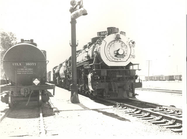

DYNAMIC BALANCE AND SOUTHERN PACIFIC 5021
The 4-10-2 “Southern Pacific” Type was reportedly built first for the Union Pacific as the “Overland” type - but it was the SP order that gave the name to the type that stuck - go figure! Union Pacific did get its own named type with the 4-12-2.
I saw the SP 5021 when it was in the Southern Pacific freight yard back in 1967 and appeared to be fairly close to operational. Oddly it was given to the local railway historical chapter who kept it “out of the way” in the SP rail yard. To my young eyes it looked very operational - albeit with a beautifully chrome plated throttle lever which seemed very loving of whoever took the time to chrome it.
Since then like most park engines the outdoor storage has taken its toll on SP 5021 - the last survivor.
Regarding the LFM - UNIVERSAL center driver, it would appear as an attempt to deal with the inherent trouble with 5 coupled axle designs and 63 inch drive wheels common to the Texas & Pacific 600 2-10-4. The balance issues of these small wheels were manifold. Alfred Bruce has the photo of SP 5000 the prototype engine showing a spoked center driver with a truely massive half circle counterweight.
It would be easy to assume the LFM - UNIVERSAL driver is an addition in an effort to increase the low operational speed designed into SP 5021 or was it rather really just a drive wheel structural problem.
The SP 5000 engines were three cylinder locomotives so the addition of the UNIVERSAL drive setup with three rods would not have been to “dynamicly balance” the engine - three cylinder drive was already fairly well balanced.

Thereupon hangs the tale. The 5000s had divided drive, with the inside cylinder angled down so the main would clear the first axle and driving on a cranked second axle using lower stroke (28" vs 32") So there is less need for rotating or recip balance in the outside mains … but it and cross balance will be at weird angles. So I suspect that the large outside counterweights are more large cored areas in the driver castings, with some of the internal space not actually weighted. It’s the rod inertia, not the ‘balancing’, that causes most of the pin and bushing problems.
Bruce said (p 301) “… the use of three cylinders permitted the power to be delivered directly to two driving axles with good balancing conditions in the 63-in driving wheels. The outside piston and main rods were unusually long but produced no ill effects”.
We should keep in mind here that this is with 25" cylinders vs the 27" for the Nines,with comparatively low pressure (225#) so the weight of the longer rods was unlikely to be “that much” of an issue. If anything it would
