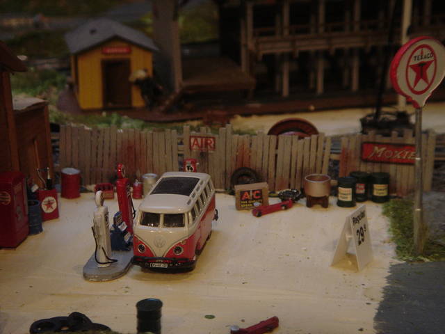

Think about the kind of fence you want around the yard. I made this wood plank fence out of coffee stirrers, and applied home-made decals for the “Air” and “Moxie” signs:

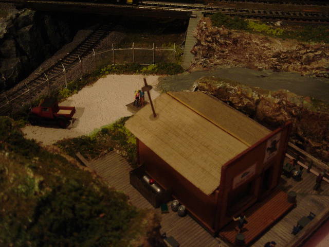

The fence behind this clam bar is Walthers Cornerstone chain-link. I first use rattle-can silver, and then I applied Dul-Cote and some weathering powders.

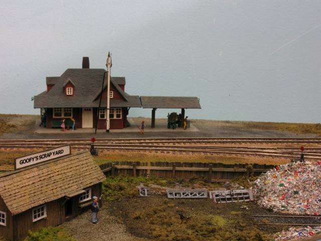

Here’re pics from an old one - now sold:
… and the other side …
Wolfgang
