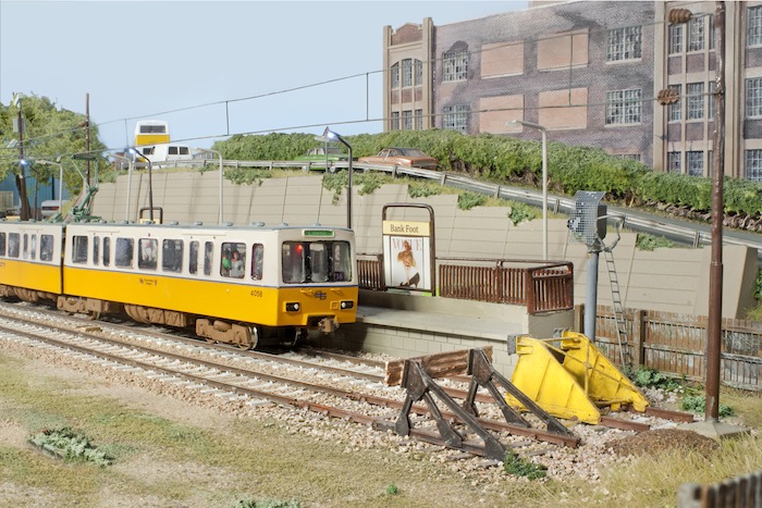

I model the late '30s, so my “modern” billboards were pretty simple to build from strip styrene, with printed paper signs…
The light shades are from Tichy, mounted on brass wire “conduit”.
https://kaleyyard.files.wordpress.com/2015/03/img_4780.jpg
Scratchbuilt using a wooden dowel, plastic sheeting, wire mesh, bits from my scraps box and internet images for the art work.
The dimensions were worked out by guestimation from Google Earth images where a known dimension was used for reference, plus some information from the old BLMA website

Very nicely-done, Trevor! [tup][tup] I also like the angle from which you took the picture - very effective!
Here’s Trevor’s sign as a picture…
Trevor, I don’t do modern model railroading, but that billboard looks great! Very well done. You really captured the look of the real thing.
-Kevin
