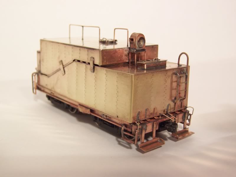

I tried those pounce wheels and didn’t really care for them. The spikes on the wheels are kinda rectangular instead of round so you end up with some odd looking rivets.
I’ve punched thousands of rivets by hand in brass one rivet at a time on my scratchbuilt steam engines. I’ve used the same method on styrene, although on a smaller scale.
I emboss them with a needle chucked into a pin vice. I’ll usually file the tip of the needle a bit to get the right sized rivet I’m looking for. What I will do is tape my work piece to the work bench and then tape my scale ruler along the rivet line. This keeps the rivets straight and I can use the markings on the ruler to space them easily. You need to punch your rivets on a surface with a little give to it. I prefer to use my self healing work matt. It takes a little practice to find the right pressure needed and to apply the same pressure for every rivet. (obviously styrene won’t take the amount of pressure need to emboss brass) I work in HO scale, but the size of the needle determines the size of the rivet, so a sharper needle should work in N scale. Be carfull though as it will be easier to punch through the styrene.
It’s really not as bad as it sounds and goes rather quickly one you get the hang of it.
The NWSL riveting tool mentioned above will create nicer, crisper rivets than what I can produce, but I can’t bring myself to plop down that kind of money. I can darn near build another engine with the amount of money it would take to buy that contraption and all it’s accesories. It is on my wish list however.

Wha?? Were talking rivets here not nail holes. I’m not going to try, but I’m sure I could count nearly all of the rivets on this Big Boy tender, which is clearly the same if not farther away than the building you posted. A new N scale steam engine without rivets wouldn’t look too good to me, and I’m sure it would cause an uproar from the “rivet counters”[;)] The trick is to get them small enough to show up from a few feet away, without being so large as to see them from across the room.
Exactly! Your photo is taken at an opportunistic angle highlighting the rivets. Show me an N-scale model that looks like that and I’ll be a believer.
