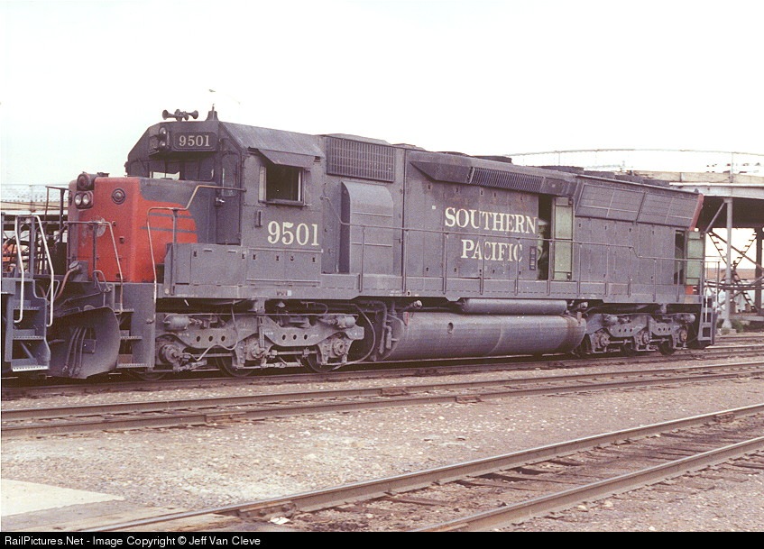

Six SD45Xs were produced.Three EMD demo units and three for Southern Pacific.SP later bought the EMD units.
Yes, they called it the SD44-2. Railfans call it the SD44R.
Foamer there were seven SD45Xs, ya forgot the first one EMD #5740 that was kept as a demo.

Here’s a shot of one of the SP SD45X units:
