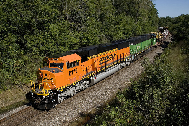

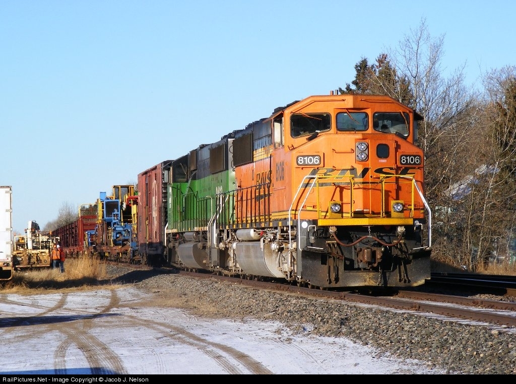

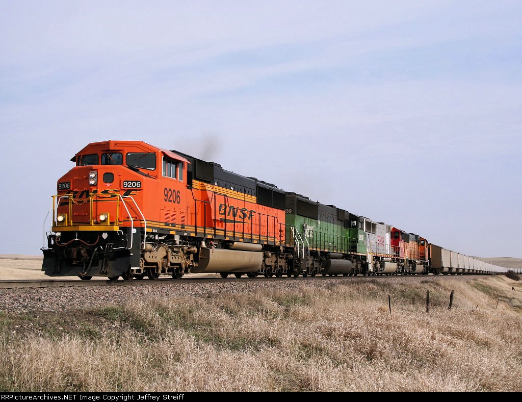

Will they retain thier paint scheme?
A few look to be out there with H3…
However, some are out there in this simplified paint version…
From all of the pictures that I have seen and have been posted above. it looks like all of the 1400 series SD60’s are being repainted into the H4 paint scheme with the H1 stripes, wider orange band and swoosh logo.
