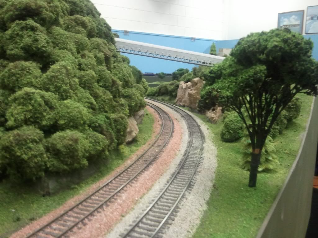

Depending how ‘dry’ your fall is, the sedum may be ready for harvesting. The tree on the right of the attached photo is made from 3-4 sedum twigs. I bind them together with brown floral tape and spray the entire tree with a camoflage brown or black can of spray paint. Once dry, I spray the canopy with cheap hair spray and 'flock ’ the tree with a mix of ground foam. I hit the tree again with hair spray and clean any ground foam off of the trunk/lower branches. I can build a tree in 5-10 minutes. This one was harvested in the spring after a cold Minnesota winter!
