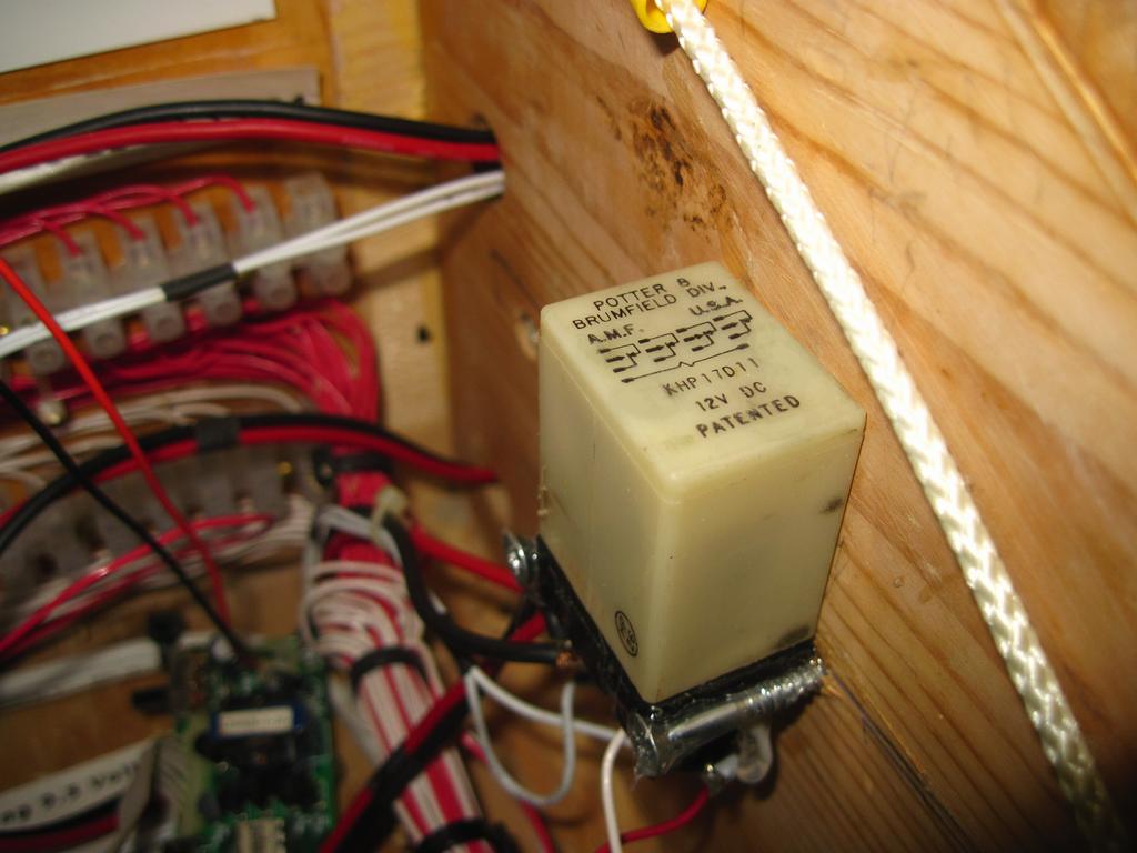

I’ve been operating my layout in Dual Mod for years without any problems. I also use a DPDT arrangement for switching. As I’m getting up there in age and I’m not as alert as I was 30 years ago so I built in a safety interlock into my switching. I went with a DPDT relay driven from the DC power pack AC accessory out put. When I turn on the DC power pack the relay pulls in and switches the track from my DCC controller to the DC power pack eliminating any possibility of operator error.
The DC Power pack Accessory output is normally AC so you need to put a bridge rectifier in series with a DC relay coil as shown in my drawing. You could use an AC relay but the relay will buzz. The relay in the picture above is a 4PDT 12 volt DC relay, I paralled the contacts for higher current and longer contact life. It’s been working for about 13 years without a single problem.
