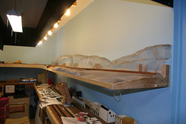

EDIT #2: Found a pic of Lee Nicholas’ UCW layout. The fascia on the layout and the valance, as well as the ceiling, are painted black to maximize the museum diorama effect:

Guy: The first pic is exactly what I’m going for.
