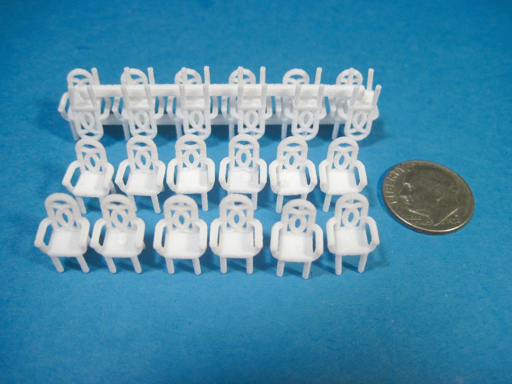

I ordered some HO scale arm chairs for my SP Heavy Weight Diner car from Shapeways two weeks ago and they arrived this afternoon. I thought a Picture would let the Forum members see the quality.
Click on the picture to enlarge.
I bought two packages of chairs. Both are perfect.
