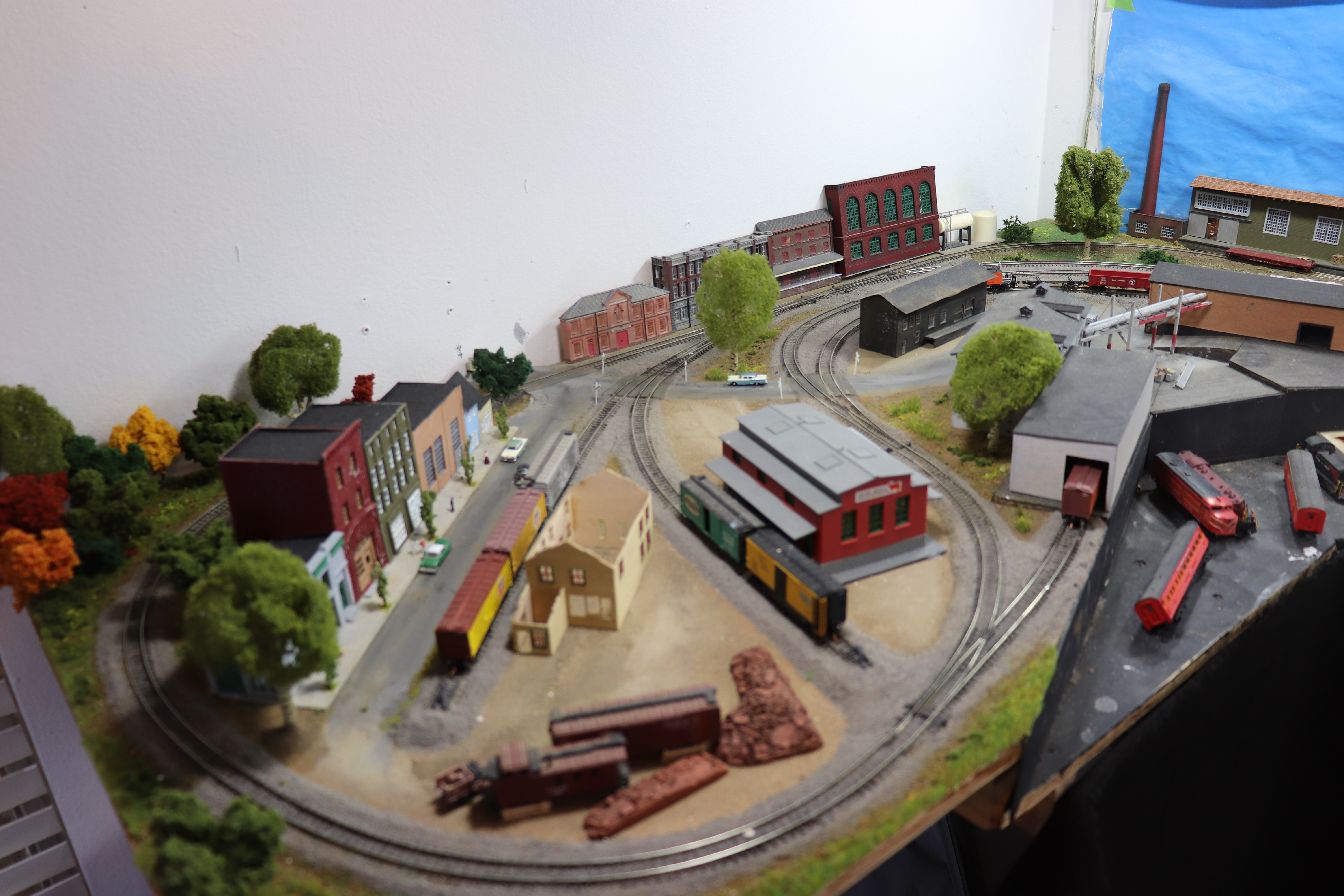

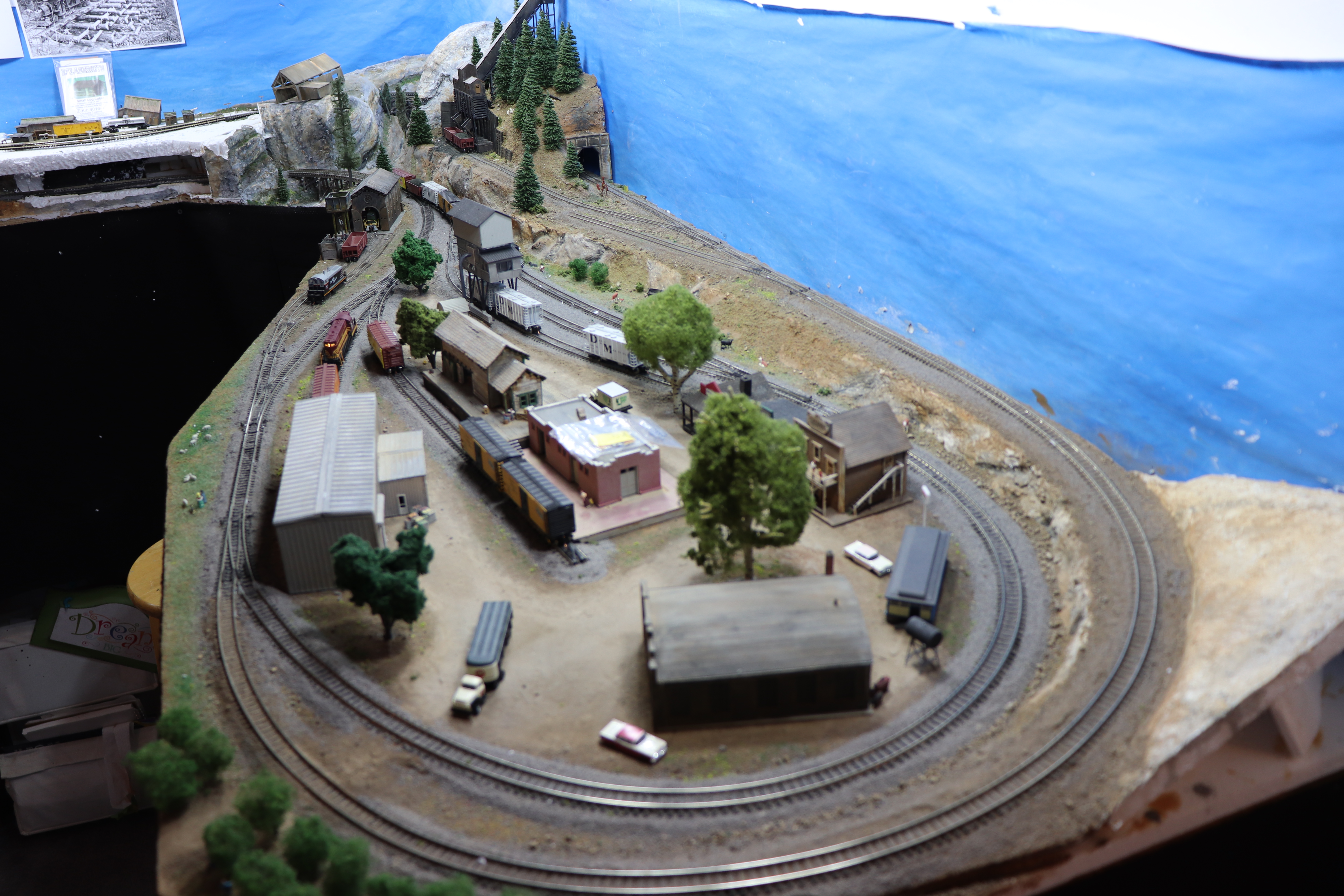

I am rebuilding the logging camp, but in the pic below, that area and the area where the coal mine are, are only 12" deep.
I found, that at 24", with the track at the back, wiring, soldering, ballasting, and basically anything related to the track installation was not easy. Needed to stand on a stool - try soldering like that :slight_smile: I have a 6’ wingspan and for me 24" deep X 51" tall is about the max.
Here’s some pics…
The East Side (Switch Junction)
Switch Junction
Left to right, new logging camp, Virgin River Gorge, Cyndi Ann Mine
Central
Port Smith
Port Smith
Brownsville - including the West turn around loop.
Brownsville
Hope this helps…
