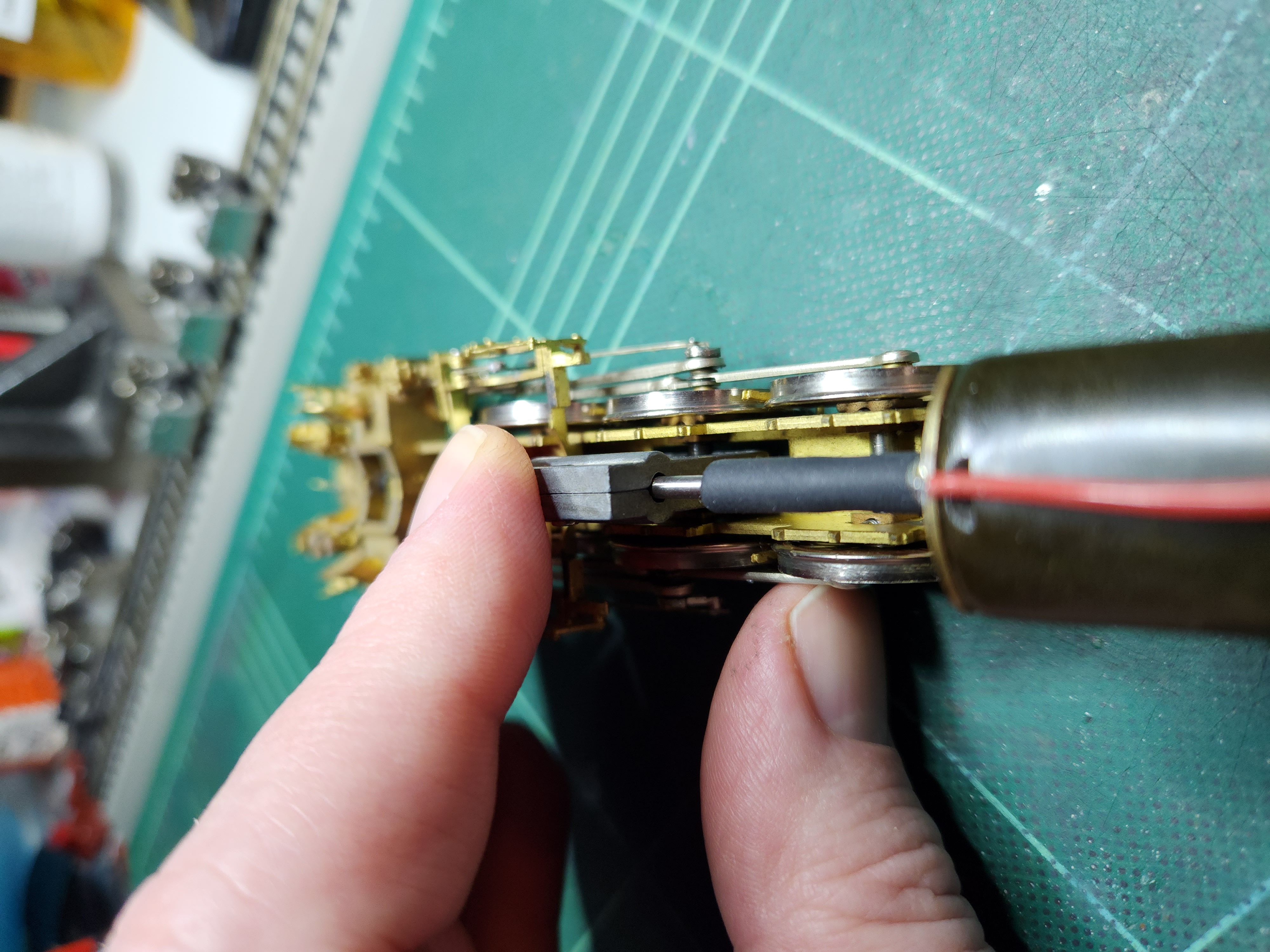

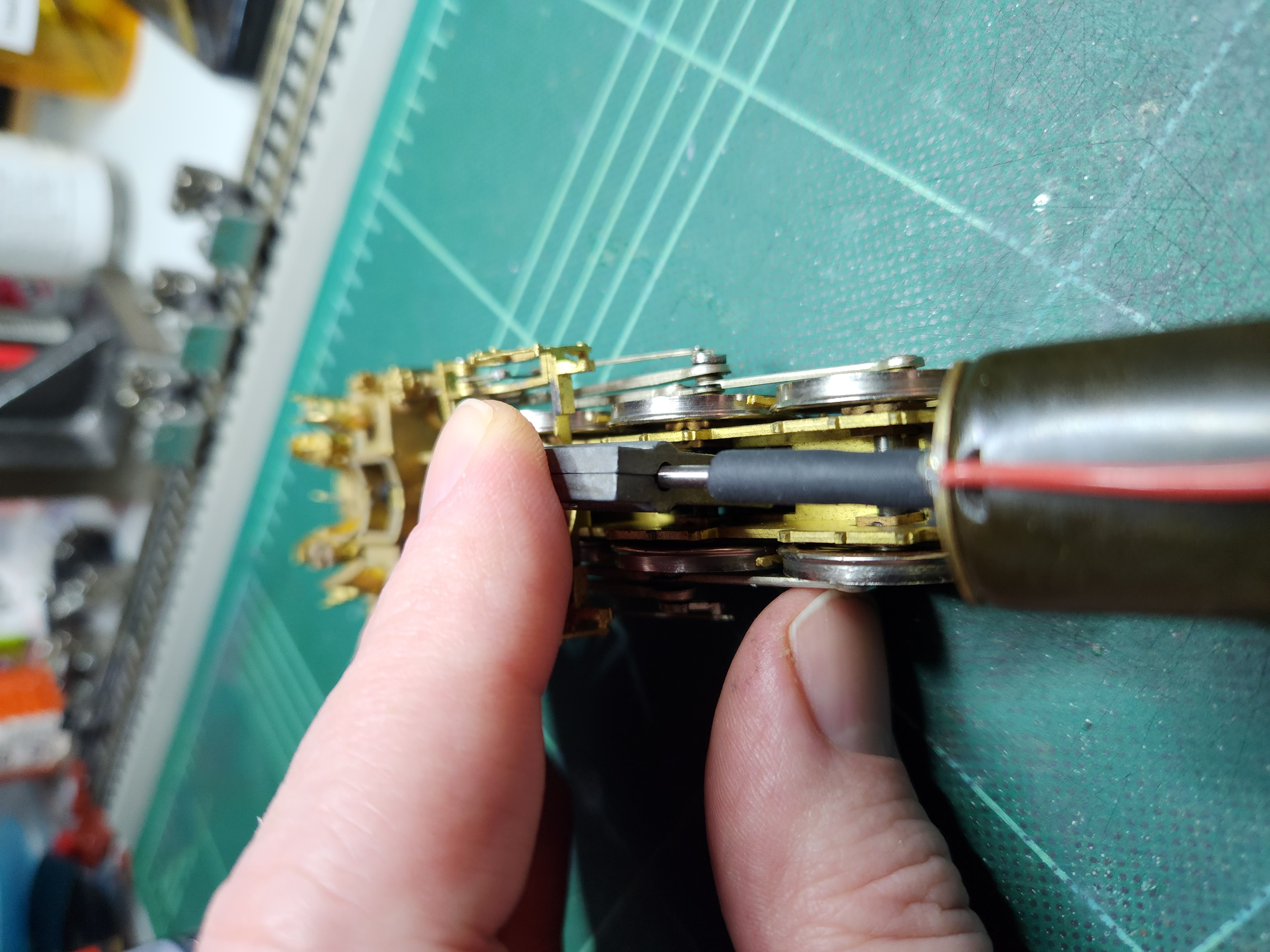

I have a brass locomotive that has too much axial play at the top of the gear box - i.e. the gear box rocks back 'n forth slightly axially with the drive shaft:
Because of this, the drivers bind slightly.
I’d like to add shims on each side of the gear box axle to minimize the rocking so that the locomotive runs more smoothly. If I press down on top of the gear tower to keep it from rocking, there is a noticeable difference in smoothness.

Thanks for the confirmation and the universal kit suggestion. The gearbox is solid fore & aft; it’s the “roll” that’s the issue, as shown below. Agreed - The torque arm should do the trick. [:D]

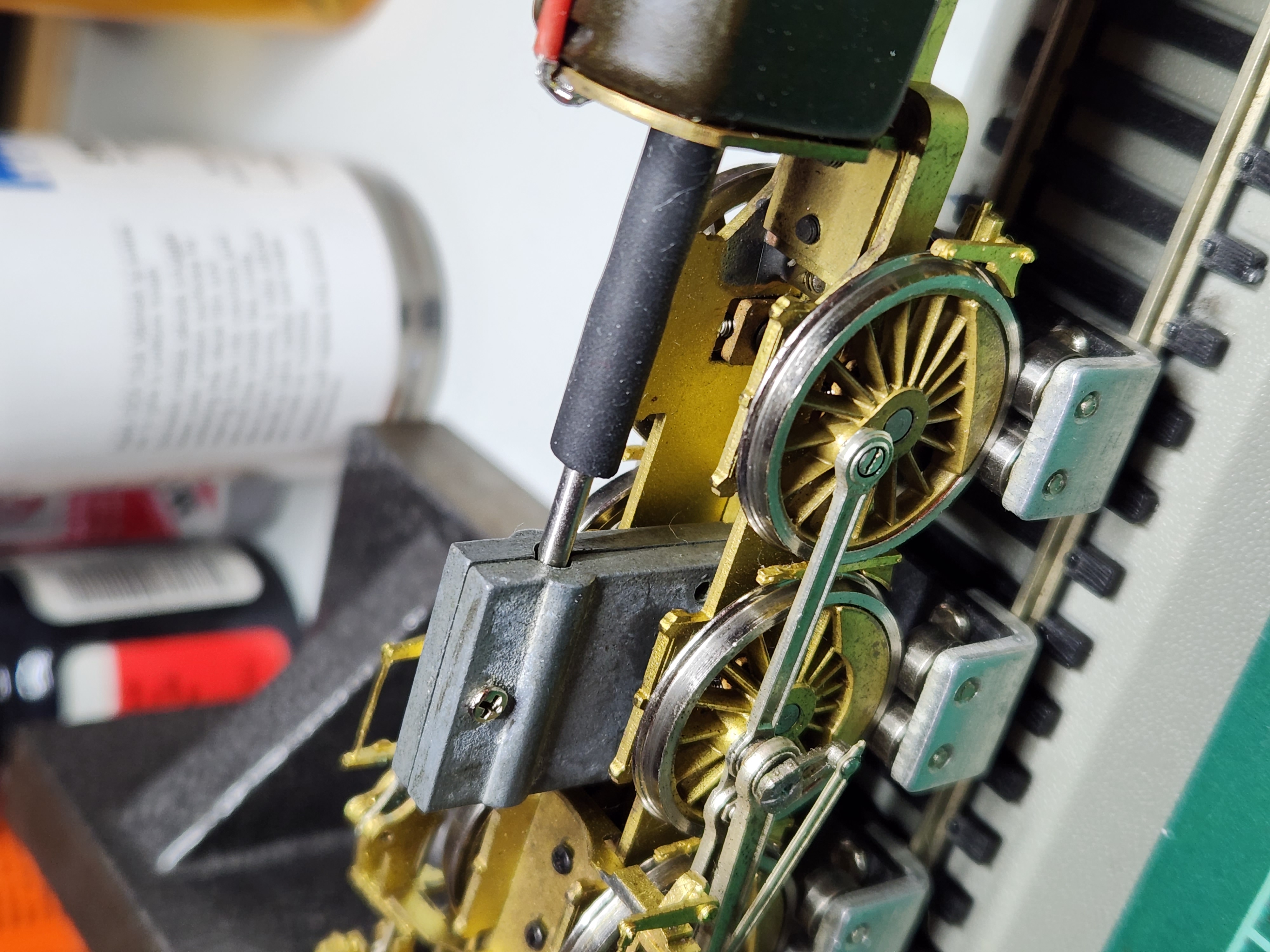

I noticed that the original black tubing was slipping on the motor shaft when the motor stalled so I replaced it with DuBro silicone fuel line, which I’ve successfully used on a few other locomotive rehabs:
Not only has this eliminated the tubing slippage on the motor shaft, the axial rocking has diminished noticeably, as well - although not completely. The torque arm will still be needed - especially if I want to get improved slow-speed from the locomotive.
Another thing that I just discovered is that the gearbox rocks considerably less in reverse than it does in forward.

It may be the angle of the photo but it appears that the motor and gearbox shafts are on a different level. I have found that same situation on 90 percent of my brass too. And when the driver springs compress it will be even greater.
I have fixed this several ways. Slot the holes in the motor mount. Shim under the motor mount. And slant the gearbox rearward and tilt the motor shaft/mount to line up. I also line up the shafts with the springs fully compressed. I always add as much weight to the locomotive so the springs are fully compressed anyway.
Another way to fix the gearbox wobble side to side is to file the bottom of the housing and maybe a little off the lower cover. Careful not to take too much off. The mesh of the idler gear and axle gear will be too deep.
