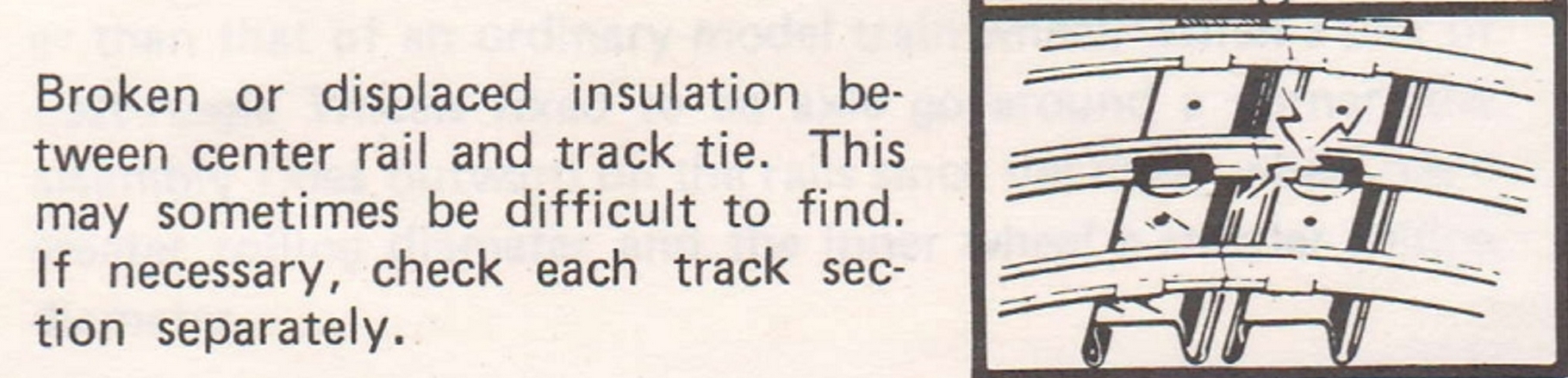

Also check to be sure that all your center rails are insulated from the ties. The card/fiber insulators may have worn.

Especially this.
