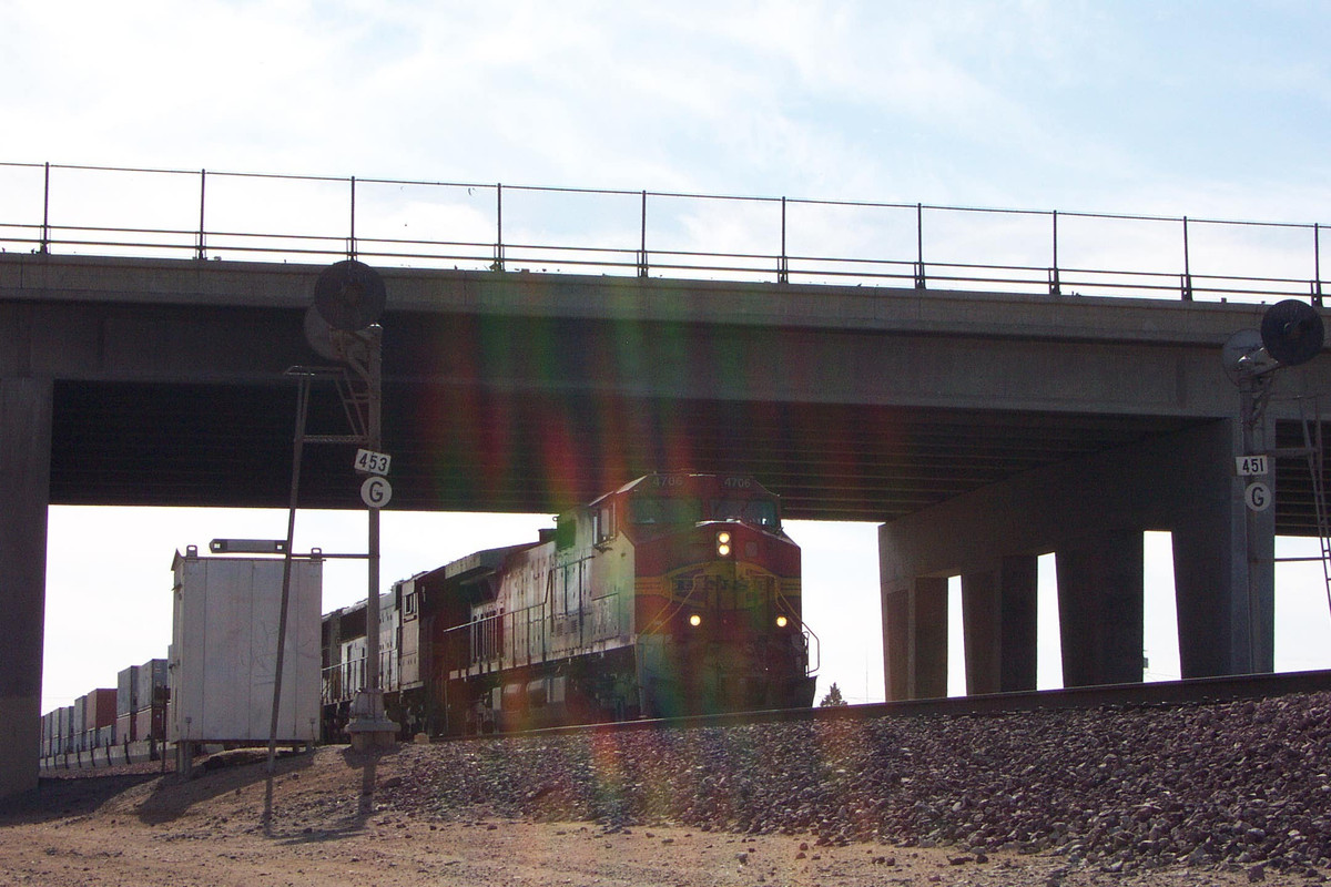

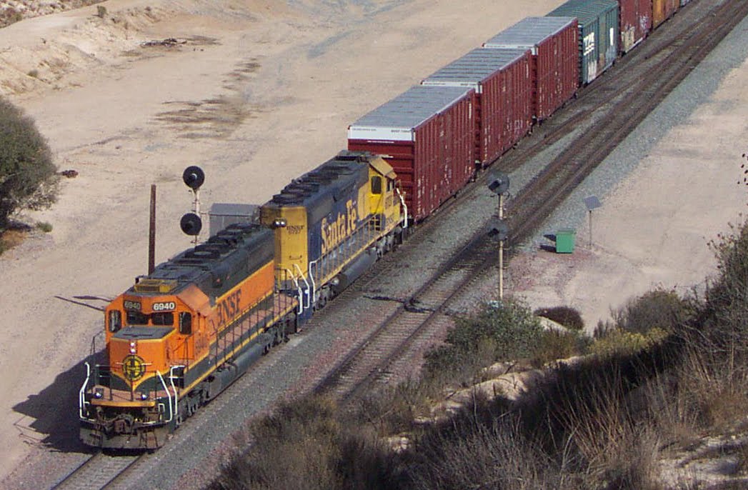

A couple from the searchlight days in November 2002
Many railroad signal rule charts have aspects that include a dark signal head. Even some where the top head is dark and the bottom head is lit.
