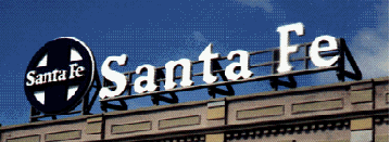

I would like to make some signs that sit on top of tall buildings for my layout. These signs are typically tall letters mounted on framework like the one in the photo below. What are my various options to make such signs? Decals on clear plastic? Stickers? Cut out lettters? I need some help and advice. Thanks.

OK, guys, thanks for that info.
Let me up the ante a bit on my search. I am planning different signs including, but not limited to, the Santa Fe sign. Like the Santa Fe sign though, the signs that I need to make will include both capital letters and small case letters. And some signs will be white letters and some signs will be red letters.

Thanks everyone for all of your suggestions and ideas. They are all good, but I remain uncertain how to proceed.
What I need is a lettering scheme containing both upper case letters and lower case letters in a font that closely resembles the lettering on the prototype signs that I want to install on some tall buildings.
What I am thinking of doing is to set up the lettering scheme on my home printer to get close to what I want and then go to someplace like Kinko’s and see if they can print vinyl stickers on a clear background or maybe decals that I can mount on a clear acrylic background atop the buildings as in that photo I attached in my initial post on this thread.

Here is my problem. I want to faithfully reproduce the sign on top of the building to replicate the one on the prototype. To do that, I need a specific size in terms of height and width and exact letterting with a specific font type. I do not believe that Miller Engineering accepts custom design orders and even if they did, it would probably be cost prohibitive, at least relative to the benefit.
I should have been more specific in my initial post as to what I am trying to do and what I am looking for. I think that my most practical solution for the issue at hand is to figure out some way to have a printer, home or commercial, print out a sign in upper and lower case letters that can be applied to a clear solid background mounted on the old style wood or metal billboard framework. That solution will likely be a vinyl sticker or a decal set up.
