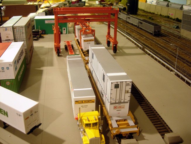

This is .060" styrene that is scored with a utility knife and painted using Floquil concrete color paint.

I used sheet styrene to build the concrete floor in my roundhouse, and here the link to the web page that shows the steps I took to get er done!
http://piedmontdivision.rymocs.com/rh_01.html
And here is one recent photo of the RH interior and floor. I’m still working on more details for the interior, the retractable roof is removed for a better view:
