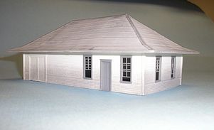

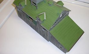

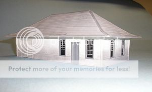

For simulating tarpaper roofs, I use .005" sheet styrene, which scales-out to just under a half-inch thick…
Apologies for the excess of photos, but it was unusual for photobucket to be sorta functioning, so I couldn’t pass-up on the chance to use them.

Hi Wayne,
I have a bit of experience with real tar paper (no granules) and rolled roofing (with granules) and I have never seen anything that is close to 1/2" thick. Having said that, your roofs do look great so I think this is a case of where a bit of exaggeration works well in modelling HO.

I agree, Dave, that a half-inch is too thick for tarpaper or even roll-roofing. All I wanted was something easy to add, and permanent. The roofs on those section-car sheds are .060" styrene, so the thinner stuff is unlikely to ever peel off.
I suppose that I could have used .001" brass shimstock, which would’ve been closer to scale, but more of a pain to stick it in-place.
