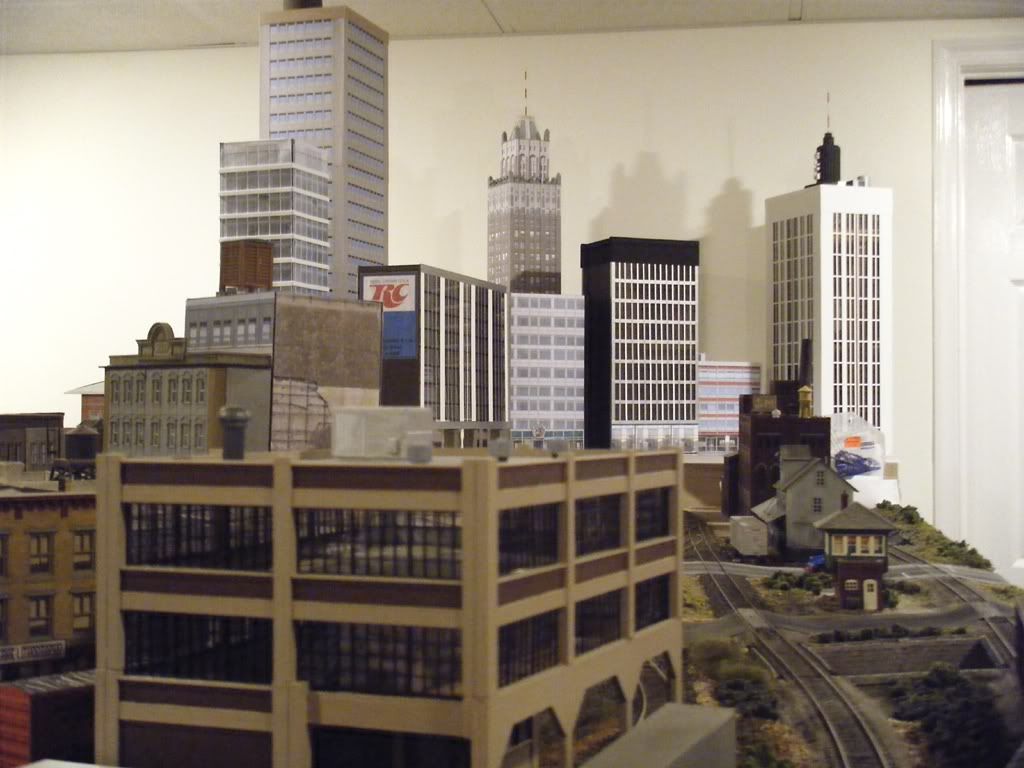

I have a few posts on my web page about this topic. There are two methods that I use- one follows the Plexiglas method first noted by Mike Palmiter in MR Mag, and the other one is one that I came up with. Either method permits you to create a structure as large as you can tolerate.
On this post, the building on the right is a Plexi and foam core shell. In the first picture- the second building on the right is a little less than HO scale since I am using it toward the back of the layout. All of my highrise buildings are a little shy of 1:87th scale, and you’d never know the difference.
http://rail.habersack.com/?p=147
This post uses a photo of a Baltimore building (I live close) that I straightened out in PhotoShop and printed. The prints were glued to a shell of foam core. One of the shots shows a construction picture. I’ve tried to use the Elmer’s 1/2 foam core when I can get it:
http://rail.habersack.com/?m=200908
This shot was over the summer when I started. The one building on the right is a photograph over foam core and the other one is Plexiglas. They both hold up well in photographs:
http://rail.habersack.com/?m=200907
Here is a little wider shot of the overall effect. This area of my layout is still under construction, so you may see my bag of Highball cinders…:
This variant of my layout has been up for about 15 months, and all of the taller structures I built since June 2009 after the bug bit. My goal is “good enough” and by no means am I a rivet counter!
