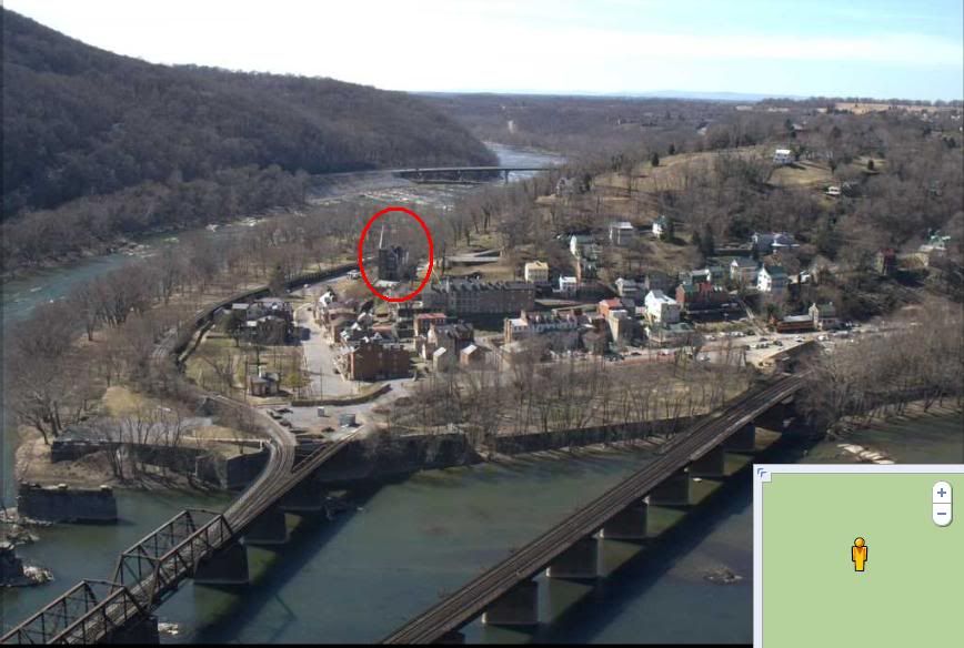

Slope can be highly deceptive. For example this picture in Harpers Ferry WV, this town looks relatively flat. But if you compare the roofs to the foundations of the buildings near it, you can see it climbs 3 stories in a relatively short distance.

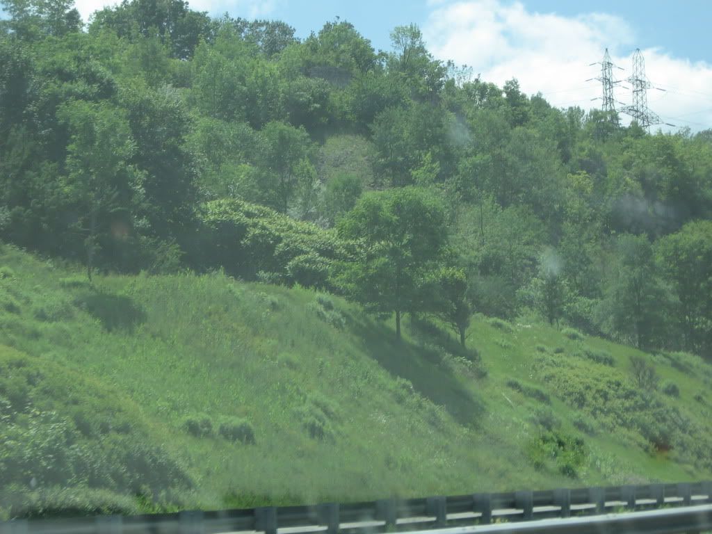

Had to drive to Hamilton awhile back…a few shots of the Niagara escarpment from the 403 heading east…

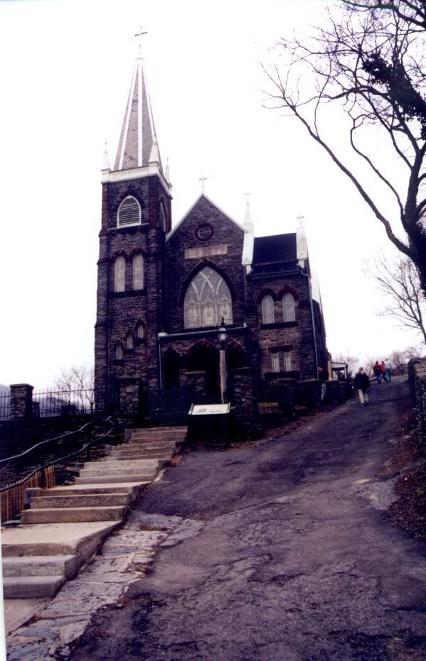

This is how deceptive slope can be.
The Church circled in red looks to be on relatively flat ground.
The Church below is the same church, and my camera is tilted upwards!

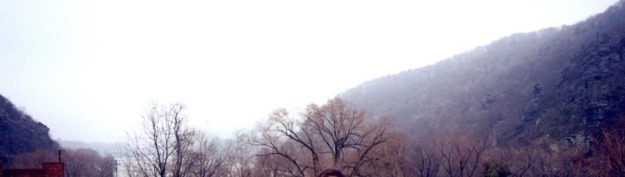

I dare say that hill in the background coming out of the Potomac (Harpers Ferry again) is a good 45 degree angle (100% grade)

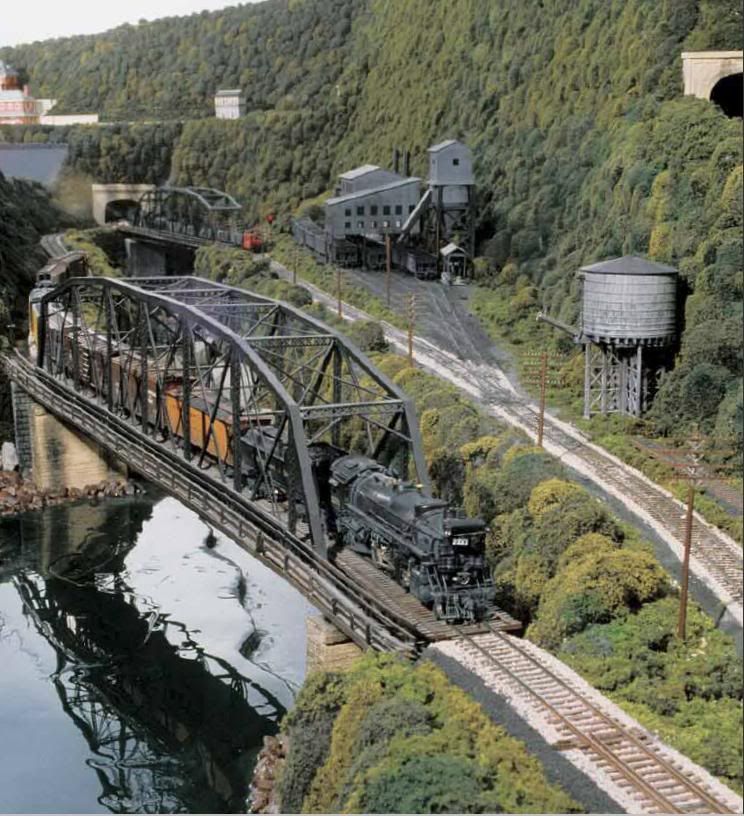

It is not uncommon for very very nice layouts to exagerate a bit on slope. :wink: (As evidenced by Dan Zugelter’s C&O layout)
Hmm-- while the scene is a bit different, the look and climb in the background is close to what I have in mind. Thanks for the photo. I’m gonna save it and print it out for inspiration!
