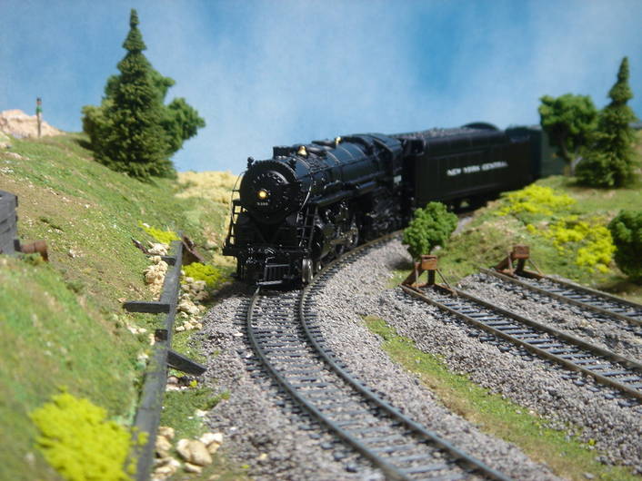

This is a BLI Hudson 4-6-4 on an 18-inch curve. This model has two positions for the drawbar to the tender, and needs to be set up for wider separation to clear 18-inch curves, but other than that it works great and looks pretty good:

Many locomotives have two different holes available in the drawbar between the locomotive and the tender. You will have to check each locomotive individually. The greater distance allows sharper curves without binding, but looks less realistic. I have been surprised that many such locomotives operate just fine through sharp curves while using the closer coupling. Test each locomotive slowly, and remember to try it in both directions through each curve.
