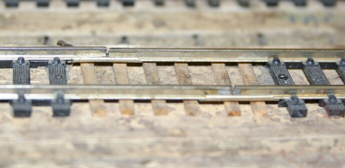

Personally if there is any curve in the track at all I hate the way track done in this manner looks. One runs the risk of destroying 6 to 12 ties, that leave a gap of 1-3 inches where there is no real support for the rail. One must put in fake ties to make it look good and hand spike the rails to provide them support through the gap. As so:
I also never solder unless it is flex track on a curve. Done in place one can loose zero ties. My soldered joints end up looking like this:
