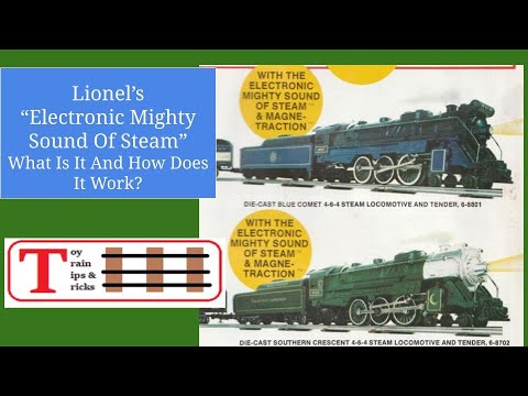

Umm, I could be wrong-wrong-wrong but I read somewhere the MPC Blue Comet had “Mighty Sound of Steam” but didn’t whistle to begin with. So there may be nothing wrong with it.
If it’s still got the original box and owners manual see if it says anything about whistling in addition to MSoS. At any rate 50 years is a long time for a circuit board, I’m surprised yours is still working. The engine I bought with MSoS (1980 vintage) let out a blood-curdling scream the first time I powered it up! I’ve called it “Mighty Sound of Scream” ever since! :scream:

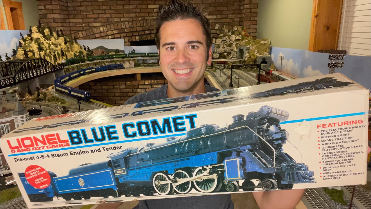

I just found this video of an MPC Blue Comet in action along with some other MPC steamers of the same era. I hear lots of MSoS but no whistles from any of them.
In fact, looking at the features listed on the box I don’t see any mention of a whistle at all.
All that being said you’ve got a real goodie there! MPC Era Blue Comets are just as hot an item as they ever were and the same can’t be said for a lot of the others.
Apparently early ones (1970- ~1972) had a whistle, then MPC had a problem with their parts supplier and dropped it. Then a different whistle came back at the end of the '70s.

I do believe you are correct. I can’t find any mention of a whistle on the box (unlike the Chessie Special), and I don’t have the manual. So while it is a shame it doesn’t feature one, the engine is in very good shape and I’m glad I have it regardless. Thank you for your help!
I’m guessing mine is from that period where the whistle was absent. The box has a copyright of 1978 on it, so right before the return. But I’m relieved to know there’s most likely nothing with it.
