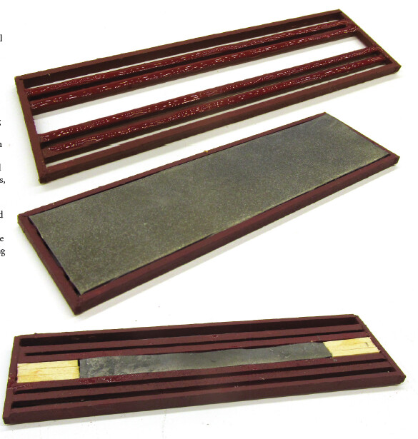

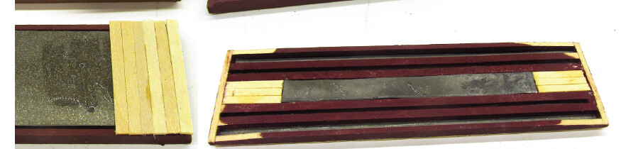

I wouldn’t go more than 1/32" thick, you can cut it with scissors at 1/32", at 1/16" it’s still cuttable but much harder on your hands and scissors. Much easier to make accurate cuts at 1/32" or thinner.

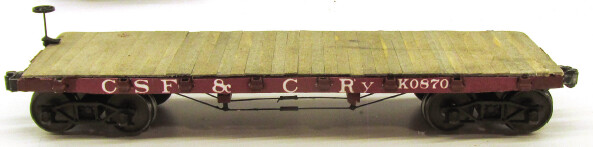

In fact, here’s some pictures of flat cars I built with a 1/32" lead sheet weight:
