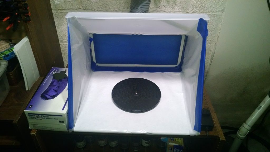

Thank you for the replies. I had hoped someone using a similar spray booth would have a solution. Most of you seem to have either home-made or professional models. Magnets or push pins won’t work for me.
Here is my first attempt, butcher’s paper for the floor of the booth, shiny side up. The sides I covered with wax paper. All attached with blue painter’s tape. I tried to position some lights to eliminate shadows but wasn’t completely successful. Just going to cover the turntable with a sheet of plain paper for now.
