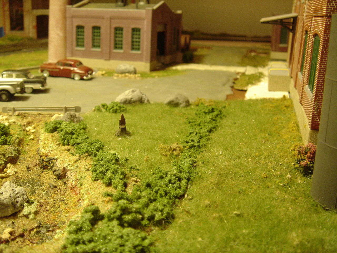

More info on static grass check out MRH if you haven’y already. They have run a couple of in depth articles. I have appled lots of static grass. I find it to be pretty easy to get great looking results. I use 50/50 mix of white glue, dont have any problems with shine etc…
The link in my sig has some pics of the grass on my layout in the gallery and pretty much all over the site.
Guy
Ohh, your a better modeler than me and I ain’t half bad.
