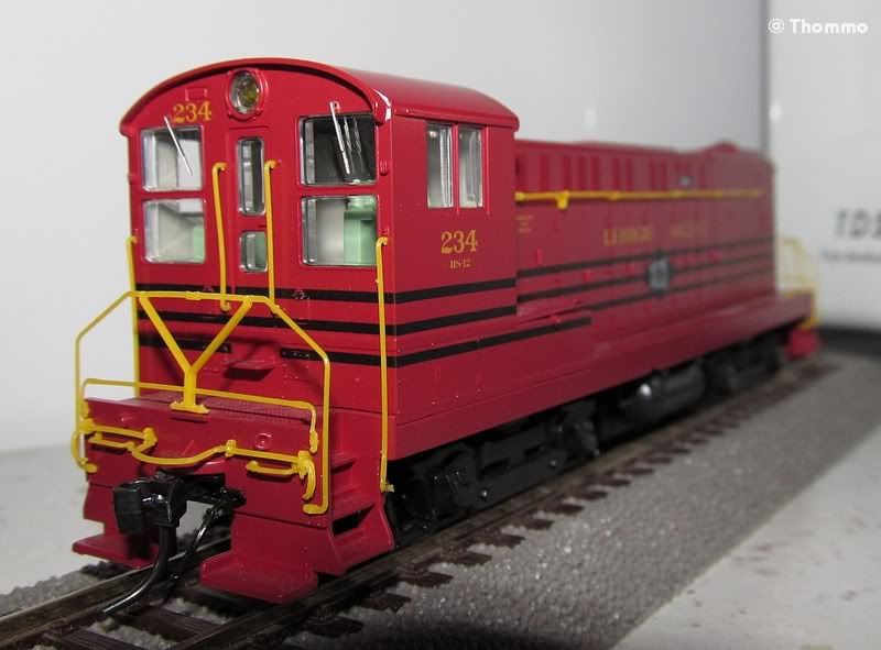

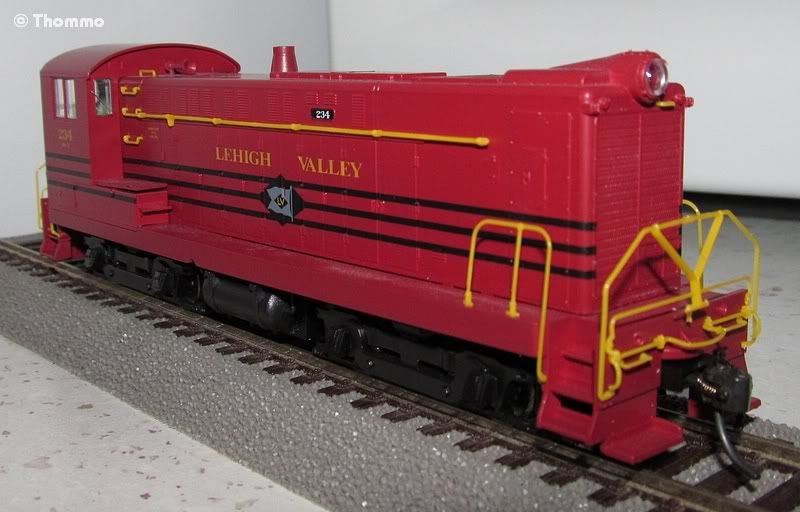

Hello, recently I added Stewart Baldwin S-12 #234 to my small LV fleet. [:)]
I find the modell very nice overall. Details are good, especially inside of the cab, running also, at least on a test track.
I have a few questions for owners of those models, so thanks for any input…

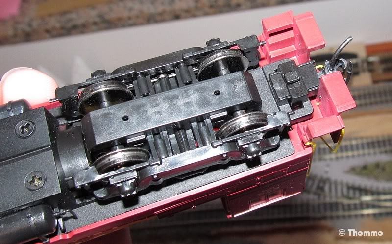

  1. I have changed the X2F couplers for Kadee #5, but couplers droops a little. There is a plastic “cover” with a pin which fixes the coupler (see photo below), but not having a screw is a recipe for drooping. Is there a better way of securing Kadee on this type of Stewart engine?
  2. The chasis is identical to the pic in the original post, Canon motor with a 8-pin DCC plug. Is there a need for a resistor for headlights if I use some standard motor decoder?
Few photos of my LV switcher:
Thommo, you could try putting one of Kadee’s .010" (gray) washers below or above (depending on where the coupler is at the coupler height gauge) the shank of the coupler. Or try the “Whisker” version of the #5, which has a thicker shank at the coupler post.
Hmm, mine don’t droop, and the runnign one (I have another still in the box, needs handrails painted and needs to have the detaisl added, just haven’t gotten aroudn to it) was assembled before the whiskers came out, so I know it has regualr #5’s in it. I think I may have put the couler together ‘upside down’ with the brass pan spring underneath rather than on top - I’ll have to pull one off to see how I did it.
No resistor needed, the resistors are already on the circuit board. I put a TCS T-1 in mine and it fit, barely. an MC2 is a better fit. Something else to do, replace the LEDs with golden-white ones, I used Minatronics Yelo-Glo. The stock yellow LEDs drive me nuts. I have some pictures on my web site, I just bent the leads of the replacement LED to mimic the stock ones and slipped them in place using the plastic clips that held the stock ones. No soldering needed, the leads of the LEDs contact the brass strips comign off the circuit board which works great - the shell comes completely off with no wires tethering it to the chassis.

I put Kadee #58s on my S-12, and they don’t have a drooping problem. The easiest fix I can think of is shimming.
