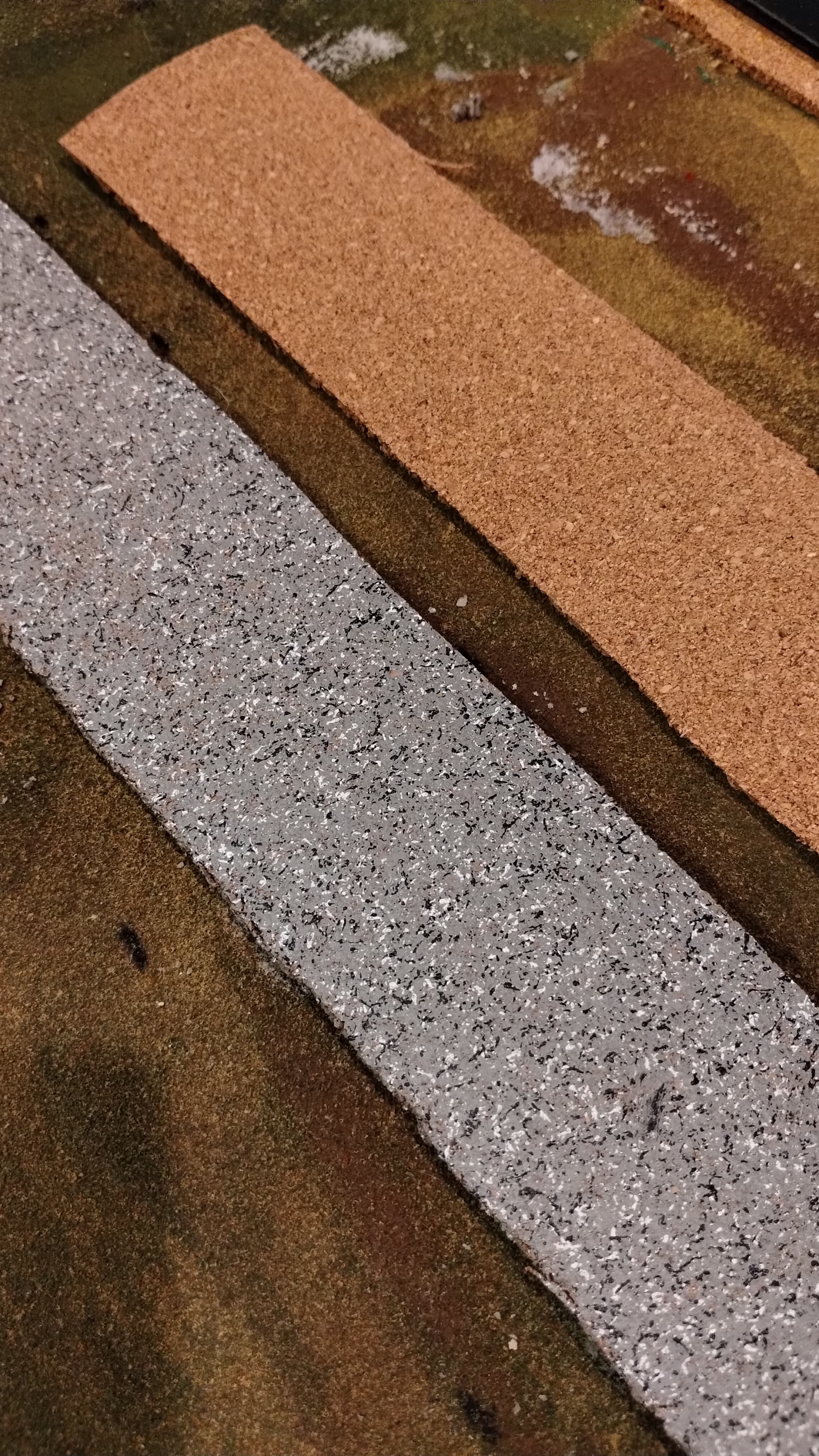

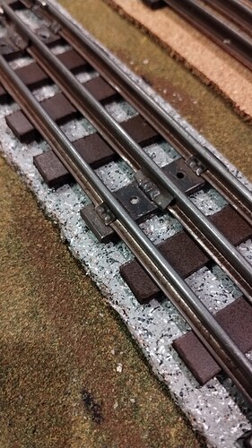

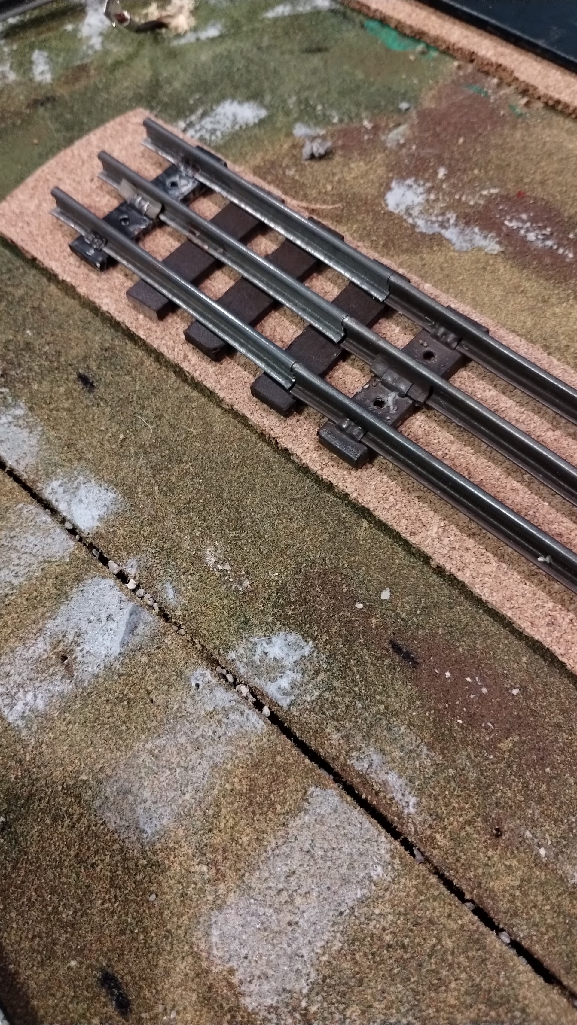

Stone fleck spray paint looks great!
Here are some before and after pictures of cork roadbed and stone spray paint. This looks way better than I thought it would. By the time I do the whole layout and landscape everything, it’s going to be nice.

That does look good!
Neat to see it used on cork roadbed, it does look good!
I use it on roadbed cut from 1/2" MDF on my clockwork layout - I’ve been meaning to add extra ties to the track, need to get going on that project.

I am modeling On30 narrow gauge which uses HO track. Would the fleck spray paint be appropriate, or do the flecks bump up an make it rough for HO track
The store I went to only had the Rust-Oleum brand, so I can only speak about that particular brand. To me, it seems to have some raised texture, but not too much, and not sticking up too high or bumpy. It’s like when you are having a small amount of sawdust in the paint, but the sawdust is laying down flat not sticking up vertically. I think it would be okay for you.
Probably the best answer I can tell you, is that the representation on the plastic cap is accurate in regards to both the color and the texture, so if you like what you see on the plastic cap, you are probably safe to give it a try. It does take 3-4 hours to dry.

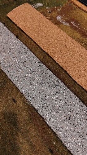

We had a warm day today and I was off from work, so I went outside and sprayed my roadbed pieces that I had cut from 1/4" cork.
If anyone is wondering, two cans of the Rust-Oleum stone paint will paint you about 35 or so feet of roadbed.
Did you use primer? I’ve done it both ways, and I prefer to spray the roadbed with gray primer, and then paint it with the stone fleck paint. Coverage is better, and the more expensive stone fleck paint goes further.
James
I did not use primer. That would definitely have improved the coverage of the fleck paint because if the gray primer showed through it wouldn’t really matter.
