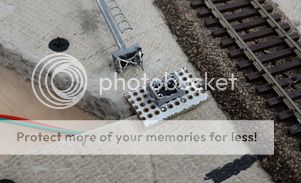

Have you decided how to mount your signals? I built some for my old club and I used a pair of six pin IC sockets to mount them so that they can be removed easily when working on the layout. When the scenery has been done the IC sockets will not show:

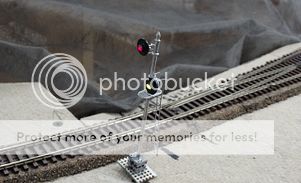

I’m making more signals for my own layout as I speak. I’m going to use RYG 0605 SMD LEDs instead of the 3mm RG LEDs I used for the club signals, and I’m going to use eight pin sockets instead of the six pin ones. That will allow me to have red/yellow/green aspects should I decide down the road to install a fancy signal system. Initially the signals will just be red/green.
Please show us some pictures of your signals.

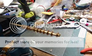

I do mine assembly line style. It may take a few attempts to get the washers square on the tubes:
Dave

It really makes the job quick and easy. Once the washers are squared up, I cut the brass tube to just a bit longer than the finished shroud, and then I can hold the tube while I shape the shroud with my Dremel. Once the shroud is shaped and filed smooth, I grab the washer with small vice grips, cut the signal head off of the tube, and then start shaping the next one.
