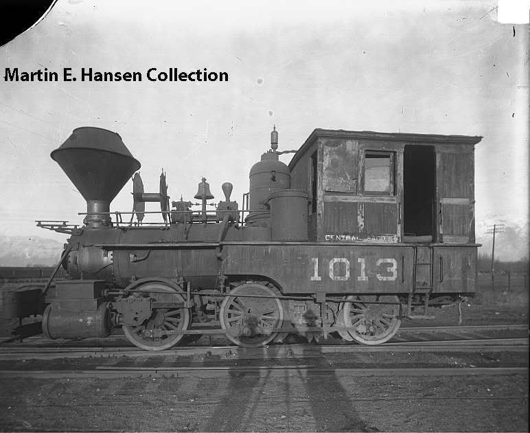

Even in the steam era, Southern Pacific used some of their 0-6-0 and 0-8-0 switchers for local service out of their Roseville, CA yards. They would send them either east up a second track built against the westbound traffic to Loomis and Penryn, CA to gather fruit reefers in season, or send them west toward Sacramento to service local industries on their main line. For the most part, both lines were a fairly straight shot, so they didn’t have to worry much about ‘nosing’ without a lead truck.
