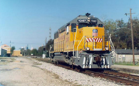

Thanksgiving Day 2007 in Houston, I heard a loco, went outside my mom’s home near Magnolia Junction and photographed this UP loco sitting at signal. Magnolia Junction wye is often used for turning locos, and is access by UP transfer runs from former HBT East Belt to a small yard on south side of turning basin.
I asked the engineer if “Y” in front of the engine number was because UP has more locos than a 4 digit number could cover. No, he said Y stood for “Yard” ie. switching service. He called the Y2107 a “Green Goat,” with low emissions to meet Houston’s environmental demands.
