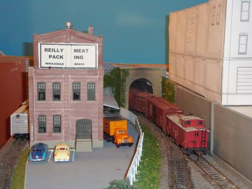

SOme of the ones I have are:
COE box truck
The blue Nash Ambassador in front of Reillys
IN this group shot, the blue, green and brown cars are Nash Ambassadors. I had a problem with casting bubbles in one of the cars, and returned it to SMCC. They replaced it, included another car, and returned the bad castiing for use as a background kit
I also have the 1950 Chevy Suburban, but can not find a photo of it.
