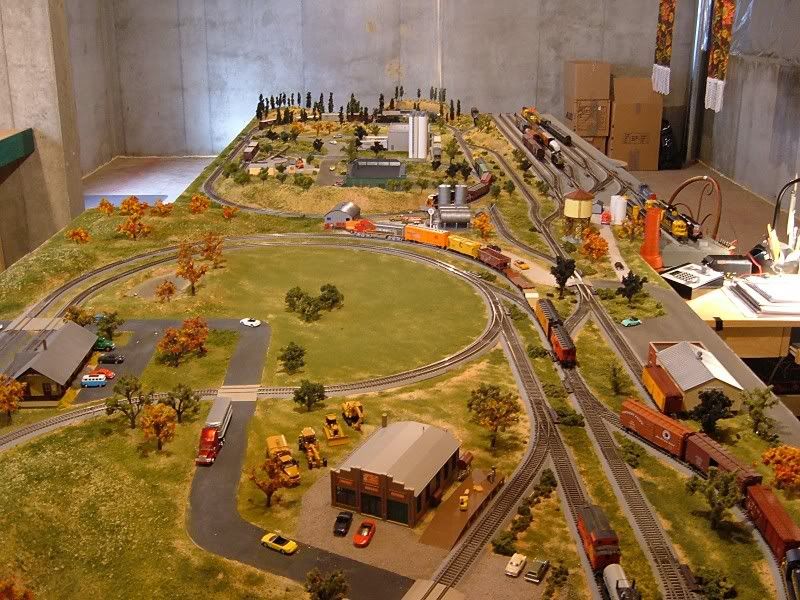

32" has worked well for me. I have two 5’ x 9’ ping-pong tables end to end and offset 1’ to allow the track plan to work. The tables are 30" high with 2" of blue foam on top. I used (3) 2’ wide strips of blue foam to make the table width 6’ (overhangs tables 6" on each side). So overall table size is 6’ x 18’.
Wiring under the table was difficult for me, and reaching into the table for scenery is a little hard but not a major problem for me (I’m 6’ tall with a pretty good reach). I’ve got some basic scenery in place but have a great deal of detail yet to add. I’ve also just started adding ballast to my Atlas True Track.
I have a small desk tucked into the 1’ offset (on the right side of the photo) and here I have my command station, computer and a comfortable office chair from which I can run the whole layout by throwing switches via DCC. I also follow trains around the layout with a radio throttle to do switching.
