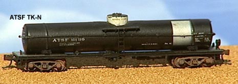

Here is my model of a tankcar which might be found at a refinery-- a company service tankcar. I understand they had a fuel contract with Texaco. Very likely usually contracted with a refinery on their own line.
Almost ANY tank car lettered for a railroad will be IN COMPAN Y SERVICE. Railroads did not usually supply tank cars for customers.Here are some references to published photos, scale drawings, information on tank cars which might service a refinery. Some are oil company cars, others are cars of suppliers to refiners…AMOX 9216 1 dome 1967 pix SF Trackside w/ Bill Gibson,p.75 1971 Eqpt Reg lists American Oil Co. AMOX 9030-9464 TM A
