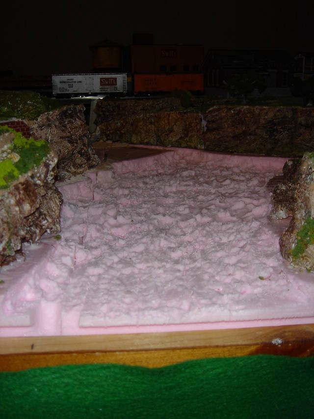

Those are sharp pictures mister. Well done,sir!
Once I get the rest of my base foam down. I’ll start my small part on the lake and small creek that will run into it.
