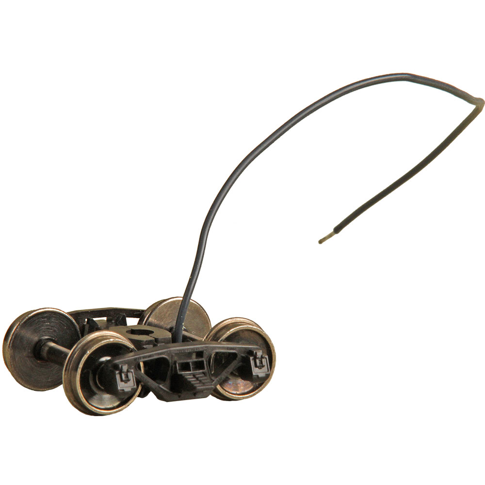

I’m looking for replacement trucks for the tender of my brass 2-6-6-2. Do the ones in the following photo appear to be Bettendorf? (Click photo to enlarge)
The brass trucks that came with the 2-6-6-2 tender use a copper “clip” that’s supposed to represent the leaf spring. It looks kinda funky with it open-ended and one of the clips doesn’t hold particularly well and rear wheel set has a lot of side-to-side slop.
I’d like to replace it with an identical truck that has electrical pickup. Kadee 590 trucks look like they might work:
I’ll try to post a photo of the brass trucks on the tender later today.

The trucks in the prototype photo have far different shape from ‘Bettendorf’ in a number of respects. It looks to me as if the sideframes your model has are very close, certainly much closer than the Kadee design pictured.
I’d at least ponder the idea of making some sort of copy of the existing truck frames in plastic or resin, perhaps with inserts for ‘conical bearings’, and make or modify suitable bolster structure to hold them, if the brass sideframes are a problem.
Tom, I love Kadee, but the electrical pickup on their caboose trucks is not reliable enough for a locomotive.
For what you are trying to do, I would suggest Tichy #3051 “Bettendorf” caboose trucks. Use Intermountain metal wheels and wipers made from Tichy 0.032" bronze wire.
This combination should give a pretty close looking truck, good electrical pickup, and reliable operation.

Tom, the Kadee truck that you showed should work just fine. Tangent also offers one that’s similar in appearance.
It’s not a big deal to add wipers to the tender trucks…
…nor is it difficult to add wipers to the loco’s drivers…
Another option would to simply leave the tender trucks as-is, and add the wipers to the locomotive.
Does Kadee make an ‘electrical connection’ version of the 509 truck? That’s a more ancient design but closer to his prototype…

Is it too much trouble to rustle up a piece of phosphor bronze and make better ‘leaf spring’ packs, or make something out of plastic that performs the combination of location and spring/three-piece sideframe action?
Even providing elastomer blocks with shaped ends under the bolsters would do most of the ‘job’ necessary to make these trucks operable. What might be more interesting is what can be done to make them optimally free-running and equalized while retaining the prototypical appearance.
Well, if you can’t correct the fault in the tender truck, that makes it an easy choice: simply pick the trucks which you feel are closest to those on the real ones, then add the wipers.
They can be added to either the tender or the locomotive, or for even better current collection, to both.
At one time, Bachmann offered their tender trucks, with axle-wipers included, but for ages they’ve been shown as sold-out. (Scroll down to the bottom of the page to see what currently can’t be had.)
I’m going to see if I can use the trucks that came with the tender. However, as an alternative, I found these brass leaf-spring Andrews trucks on the Amercian Scale Models website:
Does it seem like these would work in my situation? And it looks like the screws are for adding wipers for track pickup.

Tom, those screws are there to hold the side frames to the cross bolster.
Every brass tender truck I have seen are insulated one side only, and the cross bolster has continuity to one rail. The screws could be used for wheel wipers I suppose, but only to the rail that has continuity to the uninsulated wheel.
That is why I use plastic framed trucks on my tenders.
I just checked the three of my brass tenders I have easy access to.
None of the trucks will turn 180 degrees as manufactured. They hit the side sills, bolsters, drawbar, or coupler mount.
Tenders I have modified, similar to what Doctor Wayne posted, have wires through the floor, so they cannot turn out of polarity.
