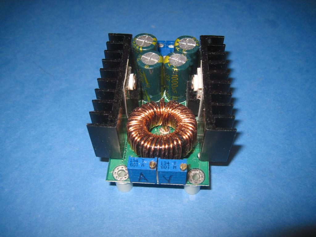

This is the one I’m using Randy.

That’s a much heftier version than the ones I have, mine are tiny - smaller than that meter even. I picked up some even smaller volt meters, too, bare board, no enclosure. I may need some of those larger ones for structure lighting, that model I can see should be able to supply a decent amount of current with the heat sinks and all. Mine are tiny little boards, less than half the size of an Arduino Nano or Micro.
–Randy
Randy
That convertor measures 2½” X 1⅞” and will handle 8 amps ambient, 12 amps forced air cooling. At 8 amps they run very cool. I set the current regulators to 8 amps on all of the convertors.
