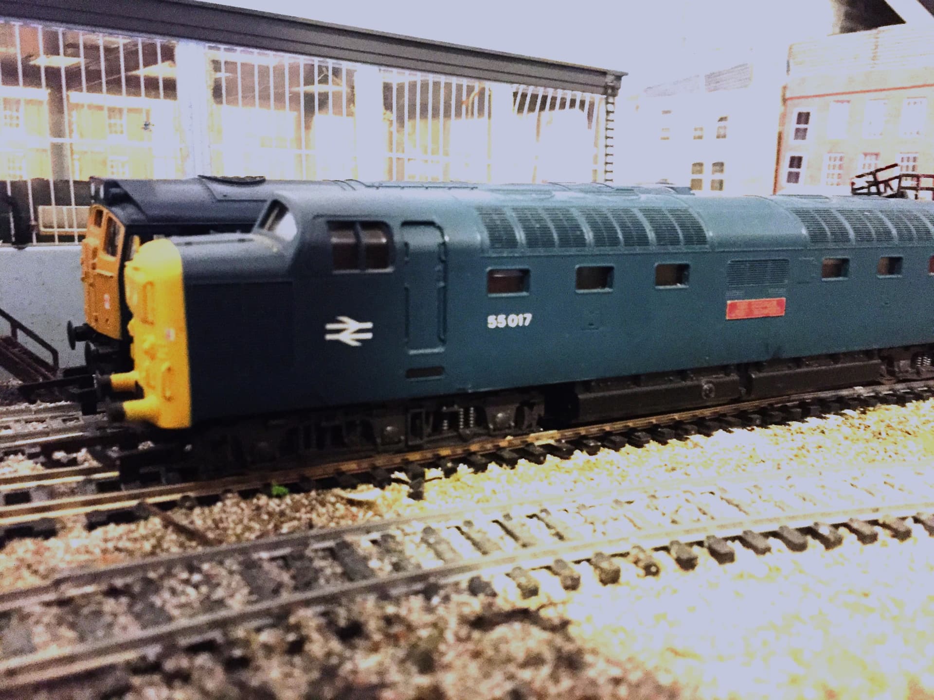

THE NAPIER DELTIC - HEART OF "THE MOST POWERFUL DIESEL IN THE WORLD"
Class 55 55017 Durham Light Infantry
