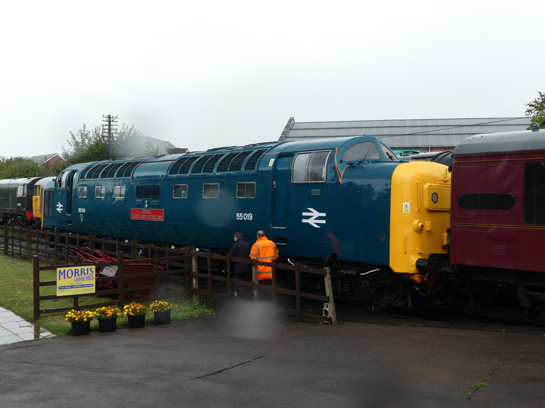

Class 55 55019 Royal Highland Fusilier seen on the Great Central Railway
