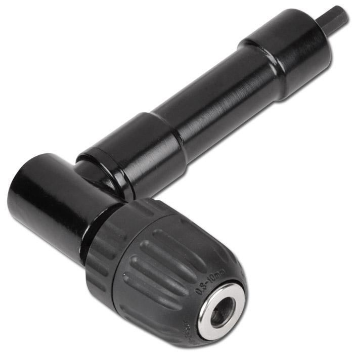

YOU MUST USE 16" Centers!!! You want to be able to get a drill between the supports for wire raceways, and even if you drill those in advance, you will always want more holes.

Lion,
I am using this:
mounted to my drill to drill holes into the supports spaced only 12" apart!
Hey, I never thought to use a proctoscope, Ulrich! That’s brilliant!
