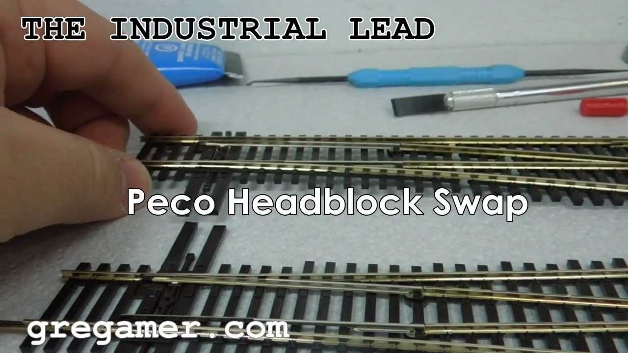

Thanks, Wayne. I was directed to a YouTube video on swapping left and right headblock ties on Peco turnouts that shows the headblocks can be removed without affecting the spring. That’s what I’ll do, then replace them with regular width Peco ties.

could you please share that YouTube link so that others may benefit?
