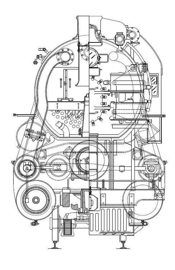

Where is the third cylinder located on a steam locomotive? I suspect it is between the two cylinders under the boiler. I can see only the two outside cylinders on photographs.
Probably if you see two cylinders, that’s all there are.
If the engine does have three cylinders, the third one is on the engine’s centerline. It might drive the lead driving axle, but in the US it probably drives the second one, so it has to be inclined to clear the lead driver axle.
This is the LMS Coronation Class in UK, four single-expansion cylinders (16½ inches diameter by 28 inches stroke) all placed under the smokebox or boiler, just like those engine with three cylinders.

I also heard that because of its internal location, the 3rd cylinder was hard to maintain.
At the time the P&R three cylinder locomotives were built, the great majority of locomotives in the USA used inside Stephenson’s valve gear, which sat between the frames. Adding a cylinder, connecting rod and bearing, and slidebars was not that great a change. The difference was that the centre rod and bearing were more heavily loaded than the valve gear and caused more problems if they failed.
By the mid 1920s when Alco jumped on the Gresley band wagon, there were few main line locomotives with major components inside the frames and the inconvenience factor was much greater. The P&R locomotives were built for better balance, and the driving gear was less heavily loaded. The Alco locomotives (and a few Baldwins) were built for greater power and the inside cylinder and rod were heavily loaded. Owing to a design flaw, the centre cylinder became more heavily loaded at speed. This affected the LNER A4s on their high speed runs, to the extent that Edward Thompson reduced the cylinder diameter from 18" to 17" to compensate. In the USA with much heavier loads they were close to a failure looking for a place to happen. The UP changed some of the 9000s to the Balwin arrangement of valve gear that at least gave more even loading on the centre cylinder. Several of the smaller roads just converted the locomotives back to two cylinder.
