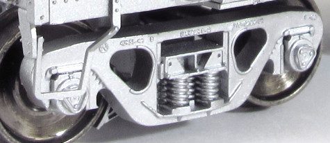

The Kato trucks seem to roll pretty well. Tangent makes the same truck with needlepoint axles, and they roll nicely too https://www.tangentscalemodels.com/product/50-ton-asf-cast-steel-spring-plank-trucks-normal-tread-metal-precision-wheelsets-copy/ . The link name doesn’t match the truck description for some reason.
It’s this one.

Those are 33" wheels, and the prototype for that truck is the Barber S-2A 70-ton design. The photos I saw of the hogshead cars appear to have the same or similar Barber trucks, at least in the few where the trucks were readily visible. Many years ago, Athearn had a truck that looked a lot like the same Barber prototype, along with another version that was more of a generic 70-ton truck with different visible springs and bearings. Neither of those are still produced but can turn up at train shows and so on.
I think the current Athearn products you linked to are the same truck with different size wheels. It’s another generic stand-in that doesn’t seem to be a very close model of anything in particular.
Maybe the instructions for the hogshead car kit date to when Athearn was selling trucks labeled as “Timken” and “Hyatt,” although the names really have nothing to do with the trucks themselves, as they refer only the the bearing manufacturers. I think the one Athearn labeled with Timken was the Barber S-2A type, further suggesting the Tangent or Kato model of that truck would be appropriate.
