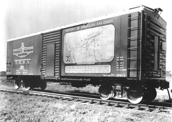

I found this one,
And in the Train Orders forum there’s a small picture of the yellow repaint.
https://www.trainorders.com/discussion/read.php?3,4089452
Scroll down a few post. You have to be a member of Train Orders to see the larger version.
I can’t make out what trucks they used.

Thus I believe there were prototypes but as you can see in the black and white photo above, the trucks on that car were very unusual and not what freight car roller bearing trucks looked like by the late 1950s to be sure. I have equipped my yellow one with conventional roller bearing trucks (and possibly not actual Timkin prototypes! Shame on me but I found a pair of Athearn roller bearings that they released decades ago where the roller bearing end caps actually turned (and they roll very poorly).

Early (late 30’s, 40’s and early 50’s) roller bearing freight trucKs looked like the ones on this car:
http://www.rr-fallenflags.org/acy/acy521w.jpg
With enclosed caps like passenger car roller bearing trucks.
The Timken promotional car had special inside bearing trucks, not sure they were ever used on anything else.
The original Athearn model of the Timken car had the kind of trucks pictured on the hopper above.

All info suggests there were no more than two Timken box cars, maybe only one, and there are no photos that seem to show the trucks on the yellow car that was at the Worlds Fair.

There is a photo in the Rock Island Digest vol 12 (dated 1995, issued by the Rock Island Technical Society) of a Rock Island boxcar # 20051 (lettered “express”) equipped with the unusual Timkin roller bearing trucks that Sheldon mentioned - the inside frame type which as the text notes were “quite unconventional looking, somewhat comparable to PCC streetcar trucks, and were very fragile looking in overall design.” That reference to PCC trucks describes the look of these things rather neatly.
There is also a close up photo of just the truck.
The text also says the car itself was built in 1941 by Pressed Steel Co. as Rick Island 147627, and was rebuilt and renumbered in 1943 with the Timkin trucks. It was an experiment and the car was reequipped with conventional A3 “Ride Control” trucks and got its old number back sometime prior to 1949.
So for at least a time there was use of the Timkin trucks beyond the Timkin promotional boxcars.

Wayne, not only was the National B-1 a popular choice for early roller bearing applications, until 1953/54, all roller bearing trucks were the enclosed design shown in that picture. They were also used on other more conventional freight trucks.

Thanks! This ties in with Mike’s response above and taking another look at the Timken car it all makes sense to me. It looks like a kit bashing kind of proect!
